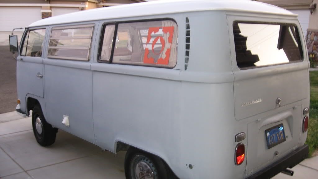

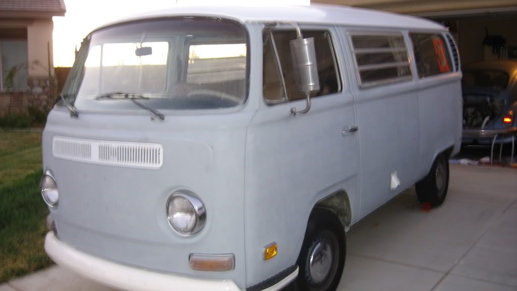

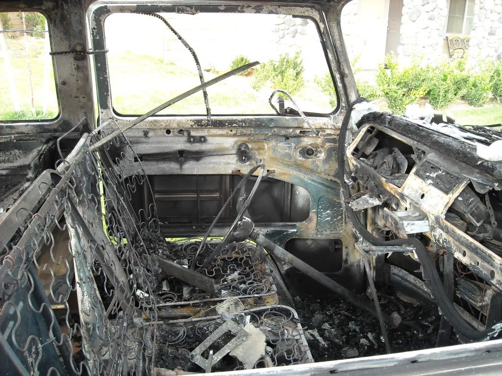

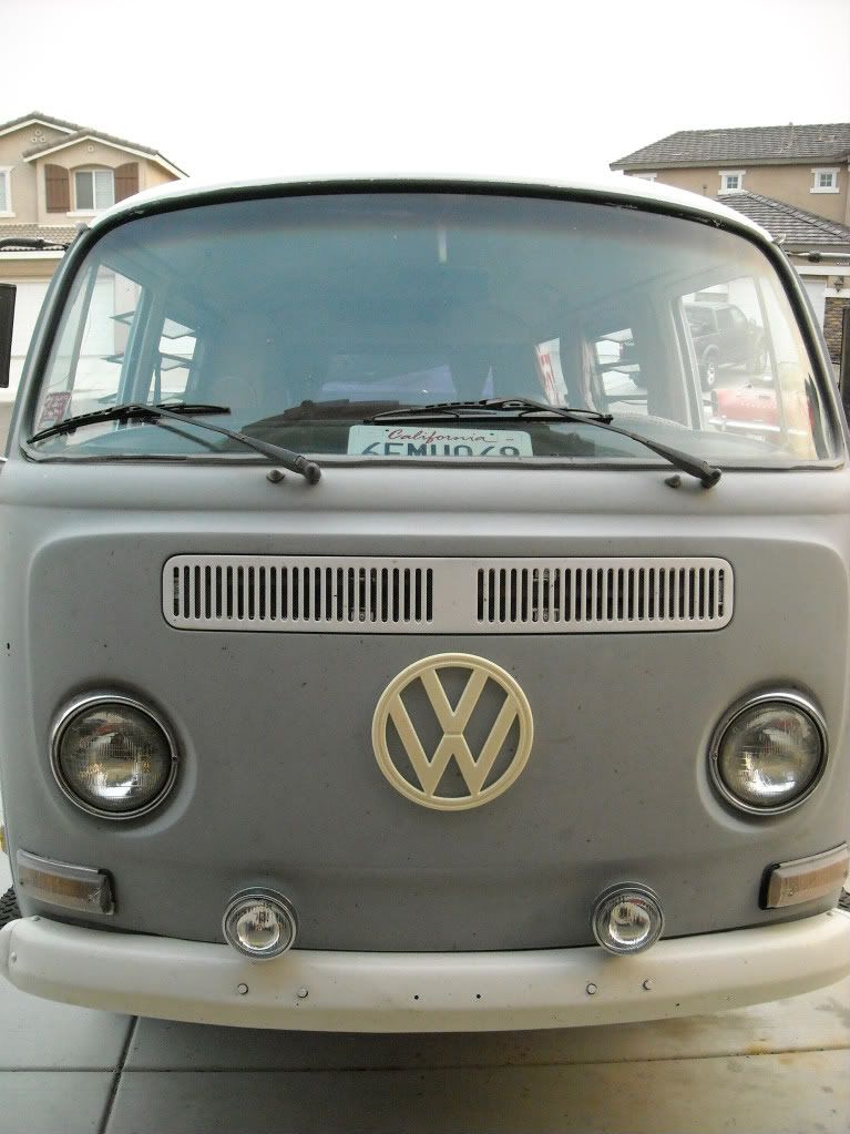

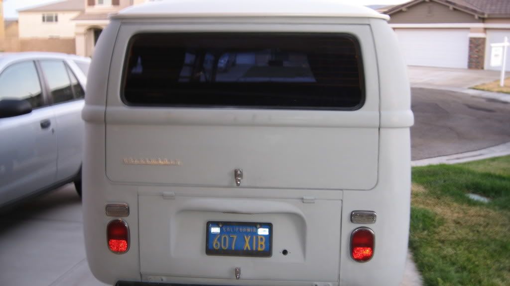

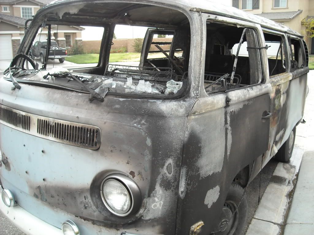

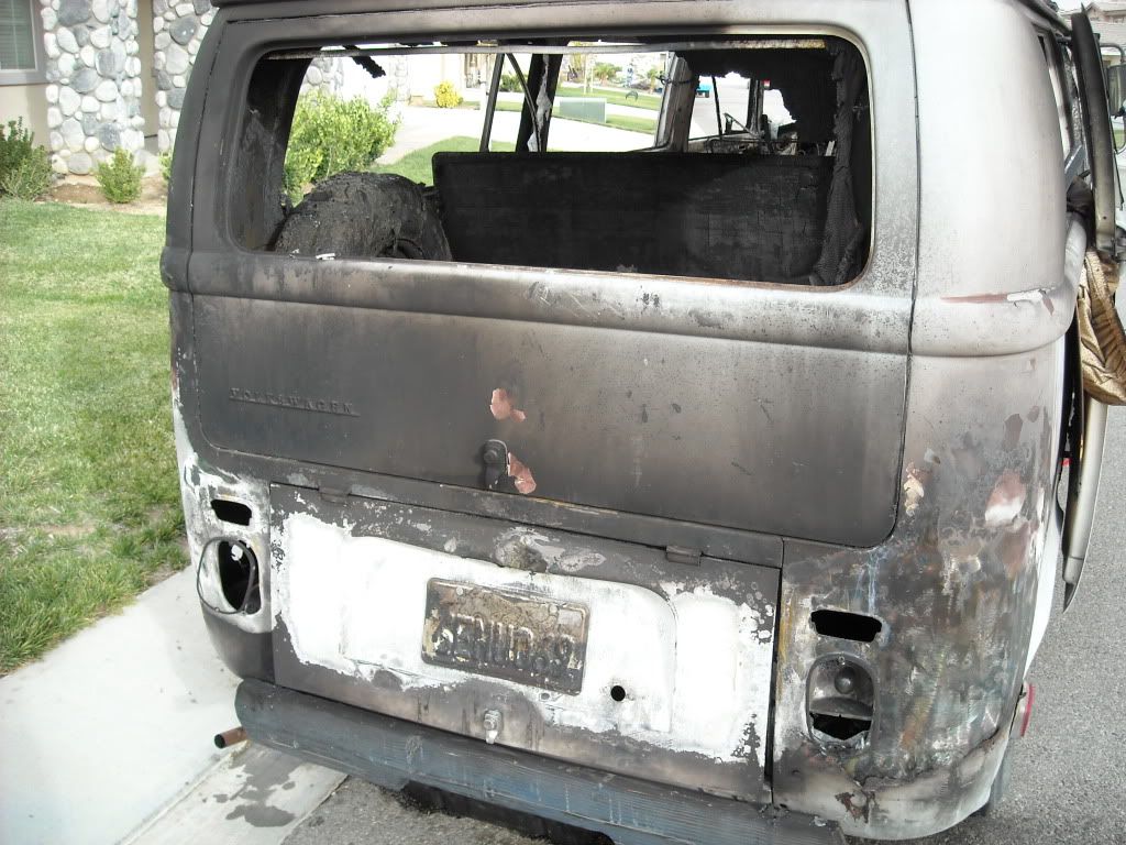

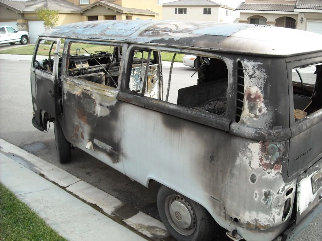

So today, October 27, 2009 is the day my first car ever, my 1971 Volkswagen Westfalia Bus decided to go up in flames. I pulled out the drive way, got about a hundred yards down the street and all I hear is a click and everythings off. Had enough momentum to pull over on the side of the road. Tried to start it again but it wouldn't turn over. Got out to go check to see what was up and all I see is thick black smoke pooring out of the vents and rear end. First thought, grabbed my fire extinguisher and ran to spray in to the engine compartment but it would not open. I knew there was nothing I could do at this point. So I just sprayed it down the vents knowing it wasn't gonna help any but i did it anyways. Luckily I had enough time to grab my tool box Very Happy, grab my blanket, and empty the dash. I couldn't get my Led Zeppelin cd out because there was no power to eject it!!!!!!! Evil or Very Mad Then I got to watch as it went up in flames Shocked , it was pretty cool but very sad. At least i'm ok, besides a slight head ache from the smoke i am good and I at least got my tool box and some things out. Just gotta move on and I'll always remember the good times I had in it. Just a feeling of utter disbelief man but I accept what happened Eh?
If anyone wants anything off it or the whole thing just pm me, i need it gone by this weekend
Whats still good:

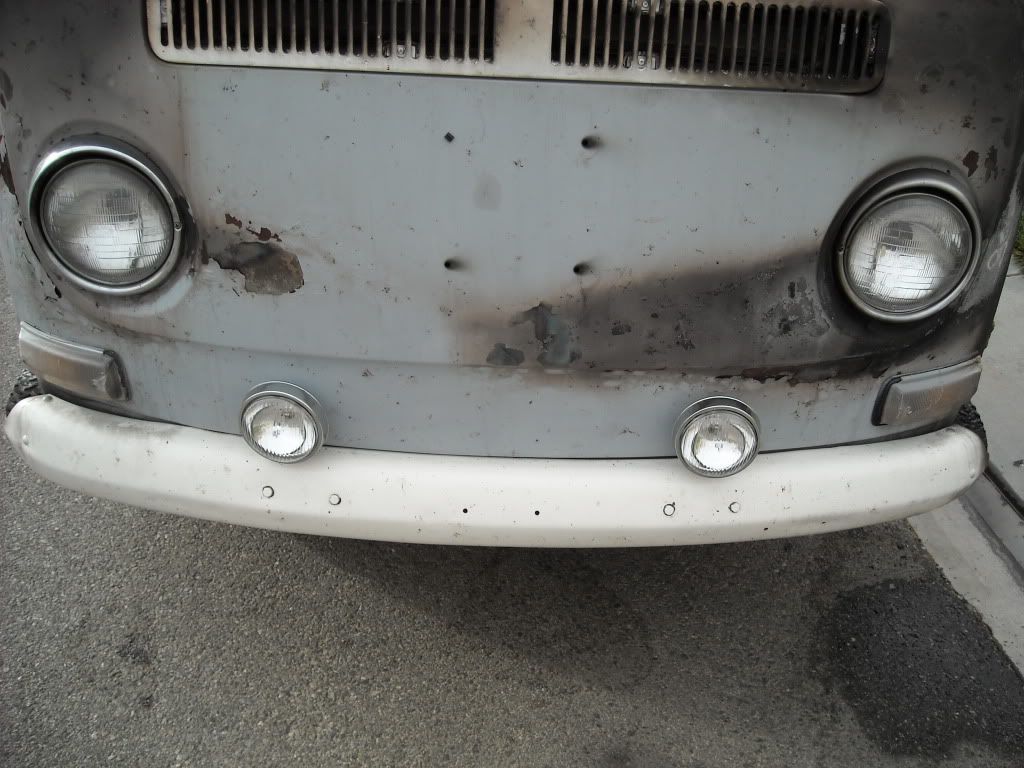

1) Front bumber, great shape...........1971 Very Happy
2) All 4 tires, rims, hubcaps, brand new Hancocks, no bubbling or melting
3) Front lights
4) I'm sure the cv's, transmission, and stuff like that underneath are good
5) Idk, sure somethin else is salvagible
Pictures are worth a thousand words Crying or Very sad

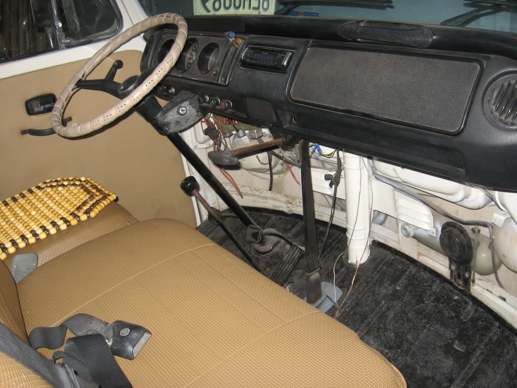

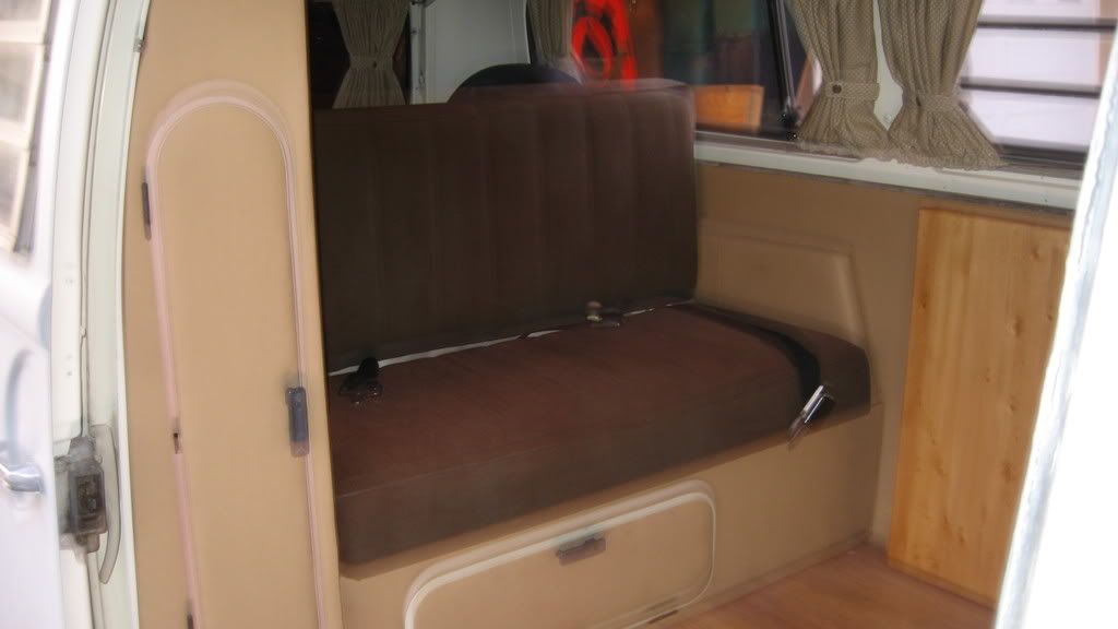

Damn, that sux man. Your interiors look good too!. I know you probably panic , I would too. But I sure hell would have pried the chit out of that engine's lid with the some tools you had in that box.
I remembered when my bug caught on fire 20 yrs ago. I saw smoke coming out from the rearview mirror and I stopped right away. Luckily the fire was put out and I only had to jerry rigged couple of wires and got it back on the road the next day. Crying or Very sad

Sorry to see those pics and hear about this.
Any idea of cause? How old were the fuel lines? I hope we can all learn from this unfortunate incident.

People need to understand that the stock VW fuel system, even factory new is an absurd fire hazard. With the tank sitting up high and all or most of the fuel lines being rubber hose it is an invitation for buses to burn readily and as we have seen here they do. It is pretty hard to move the tank to a lower location, but you can get rid of most of the rubber hose and replace it with steel line. This is especially easy on a carburated model. Make your junction from steel to rubber high in the engine compartment, above the level of the top of the fuel tank, so that when the rubber hose burns through the fuel flow will stop.
Contrary to the normal Samba rant, placing the fuel pump and filter under the bus does not make your bus particularly safe from fire, unless they are installed without the use of rubber hose. A fuel pump with an anti drain through valve will help, the stock mechanical pump had such a valve. The use of stainless steel AN braided hose will also help, but to me the best solution on a carburated model is to use a Facet style pump and filter installed high in the engine compartment fed all the way from the tank by steel tubing, with only a length of rubber hose between the pump and the carb plus another short piece feeding the pump.
This is the system I have on my old '74. Once a fire starts and burns through the hose on the inlet side of the pump, the flow will stop even if the pump keeps running. I now use AN hose on the outlet side of the pump to buy some time, but still use the regular fuel line on the inlet side.
