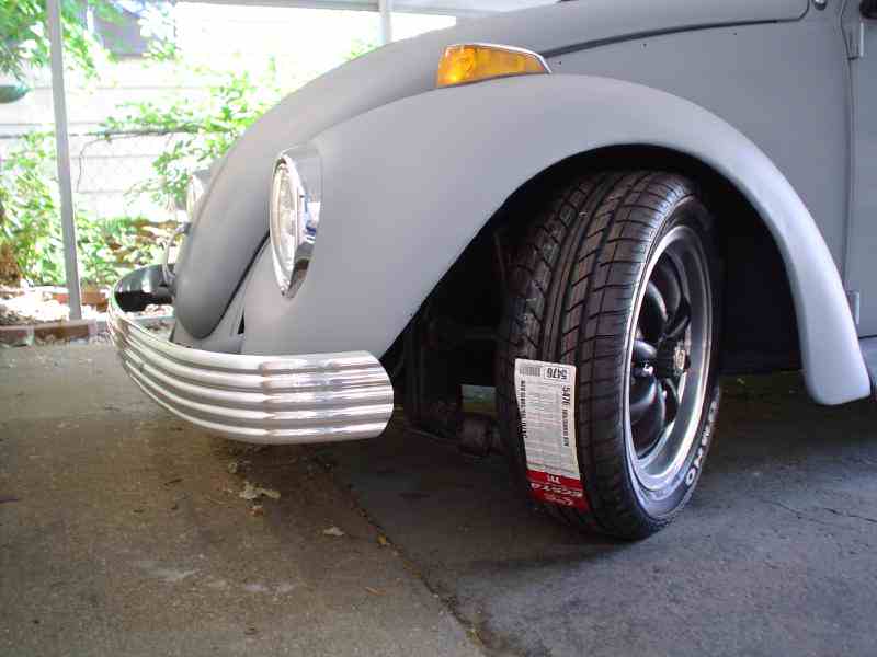

Can I run this wheel & tire combo with 2-1/2" drop spindles on my '74 Classic Standard Beetle (Not Super).
I plan to lower the rear with torsion bar adjustment.
Chrome Smoothie Wheels - 4x130 Lug, 15”d x 51/2 w with DUNLAP GT QUALIFIER Tires, 195/50R15
Think I'll have any clearance problems anywhere. I'm buying these used, so another tire size is not an option.
Thanks! Bill
P.S. Not my car pictured, but the car they are on now. Should look the same on mine without being lowered, Looks like plenty of clearance to lower it. Any opinions?

It's not the drop but the offset of the rims.
First off a 1950/50-15 is a pretty small (diameter) tire so in the rears you'll have to push the engine harder to maintain the same speed as a stock size tire.
I have 195/60-15 on 5.5x15 ET42 rims with the front dropped 3" with AVIS adjusters. If it weren't for the deep offset of the rims, the tires would rub.

If you drop it, it'll rub. The drop spindles add width and I can see on the other car that the tire tread is already past the inner lip (and outer) of the fender. If you don't narrow the beam, it'll rub.

Dropped spindles push the wheels out further than stock, so you need a 2" narrowed beam just to break even.
It's cheaper to buy tires that fit than making the car fit the tires.

If you must use those tires and rims, then you should consider simply getting an adjustable, narrowed beam and skip the drop spindles. It sounds like you don't intend to 'slam' the bug, you just want to close up the fender gap. A two inch narrowed adjustable beam will allow you to drop the car exactly where you want it and it will get those big, fat tires under the fenders.

195/65r15 tires in the rear will be great ... it's what I'm running... I run 195/65r15's in rear and 195/50r15's in front...but I went slammed so I had to go with a 5" beam and spindles...but 4" may have worked as well
... I agree with Glenn 195/50r15's in the rear is just too short a tire
Now...
if you plan to run 195/50r15 tires in front with just drop spindles you will be fine
and empi 8's have an offset similar to what your working with and are 15x5.5

That's exactly the look I'm trying to obtain. Can't slam it due to the Pennsylvania pothole filled roads. So, from your pictures, I'll be just fine with 195/50r15 tires in front with just 2-1/2" drop spindles.

If you are telling me that the above car does not rub when you're going around a corner with a passenger and you stomp the brakes I have to call BS. Those tires are directly under the fender lip. That car will certainly rub. There are still labels glued to the tread, so you haven't even driven it yet. It'll rub.

Those rims are wide for the front. I suggest a 4" narrowed beam with the drop spindle. Then use a 145-60 on the front. The 195's will be fine on the rear. You should have no rubbing issues with this set up. I have it on my car, and everything works great. Anything more than 4" narrowed makes you cut into the body. It will be a tight fit, but it will work, and you can maintain shock towers and shocks.

I think I may just get the 2-1/2" drop spindles and take my chances with that tire and wheel combo. By the looks of that picture, they will probably be alright. I don't plan on sharp cornering with a fat chick in the passenger seat and braking at the same time. At least I hope not!

If it does rub, please let us know so we can definitively answer the question.
I feel pretty certain that it will (I did almost the exact same thing on a 70 vert) but I have been wrong before.
Simple solution will be skinny tires like 145's.

I forgot to mention one very important fact. I'll be running '66 and earlier front fenders on my '74. I don't have the original '74 fenders to compare, but these fenders look to possibly be a little wider than the originals.

Bill, that's an easy question to answer... the "opinions" you are getting are what folks are using and know does/doesn't work.... there is no one right or wrong way, and that is why opinions and setups vary...
the earlier style fenders are no wider, just a bit different shape around the headlight bucket.
