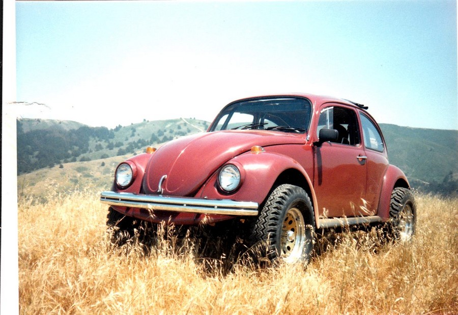

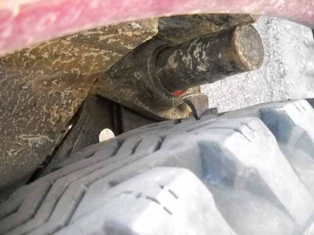

Here's mine with 235/75 ATs mounted on 5.5" wheels. I get very slight rubbing, but nothing that damages either the tire or the fenders. I do get some rubbing at full turn near the bulkhead.
I'm actually pretty happy with the 235's. The headlight buckets can be a problem without the lift spindles.

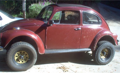

PostPosted: Fri Mar 26, 2010 8:21 am    Post subject: Reply with quote
Mods i've done to the car:
Front Beam is adjustable
3in Lift Sprindles
Rear Spring plates reindexed
I raised the rear a bit more here is a crappy pic

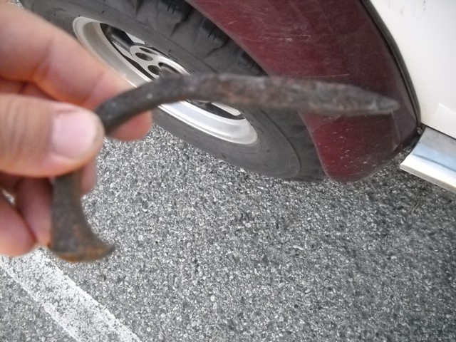

That sucks!
What is the flat from?

PostPosted: Mon Mar 29, 2010 8:35 pm    Post subject: Reply with quote
Railroad nail, lol
