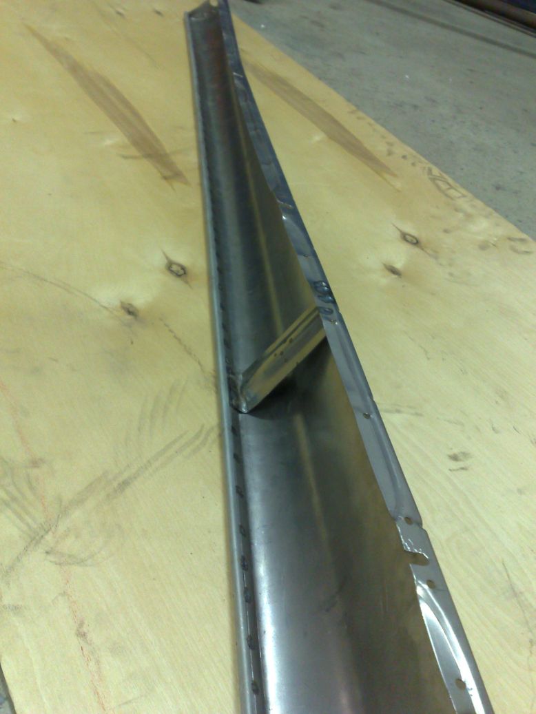

The idea to make running boards to my next project has been in my mind for awhile, now I have the first handmade steel sample ready. Material 1 mm sheet metal, rubber fixing strip 0.75 mm.
The master was my 6'52 original running board. Many details to make, strengtheners to edge and fitting side, holes for rubber mat fixing, outer strip for rubber mat fixing (fixed to board by spot welding), middle bracing, curved profil, fitting holes etc.
Sorry for poor pictures, the light is not enough, we have dark winter...

really cool result Exclamation but i think a lot of work..
have you made it freehand or did you do a wooden fram for hammering it?

Cutter, bead roller, binder, press, shrinker and other hand tools. No hammering, no wood Very Happy
okay, i see professional tooling required Smile

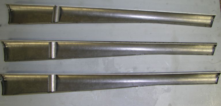

Update for this. The first 3 pcs of left side series made. Of course many protos needed to verify methods and tools, but as you know protos will be scrapped Wink
Protos:
The pattern shape.

Nice work Mika. Are those being made on a die, or hand made? Either way, I could use a set for my '51. Looks like nice work!!!
