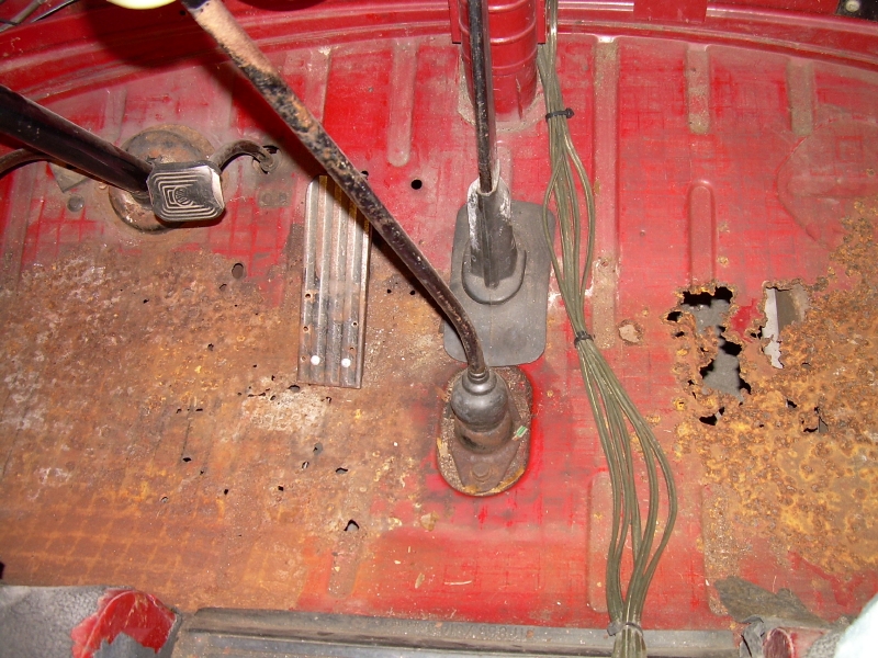

Here is what I started with:
Not very pretty unless you like swiss cheese for your floor board.

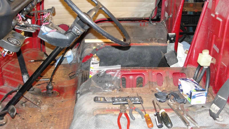

Sooo, I started by removing the steering wheel
Can you see that labeled bag? Very important for someone like me who likes to drink and stuff while workin on ole Rita.
I have seperate bags for the pedals, the doors, the dashboard, the steering, and the hand brake. This oughta help a little when putting everything back together.

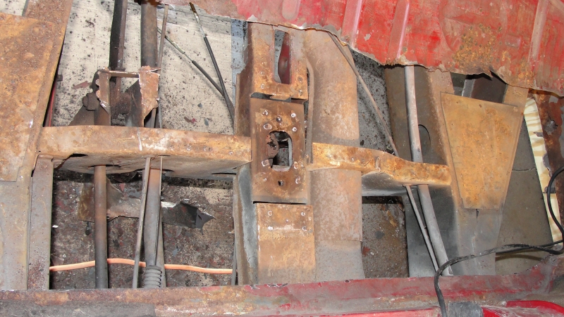

Most of the sections came out pretty easy but where the pan sits on the frame, there seems to be some spot welds (or maybe the rust is so bad it welded itself??)
You see the triangular section on the left? The pan was connected pretty good here. I had to use a cold molded chisel on this (GOGGLES PUHLEASE)
Also, the middle section where the hand brake goes. Specifically the part of the frame that runs front to back has some more welds we need to chisel:
And, the bracket that the brake servo rod goes through has some pretty good welds there too:

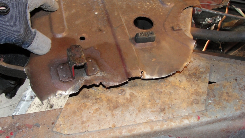

Let me take this moment to point out a very important part that does not come on Awesome Mr. Gerson's floor pan. This is a pic underneath right below the gas pedal. There is a bracket that is welded to the pan from underneath that holds the pivot in place for the accelerator cable:
I'm going to have to drill this out and weld back in place on the new pan.

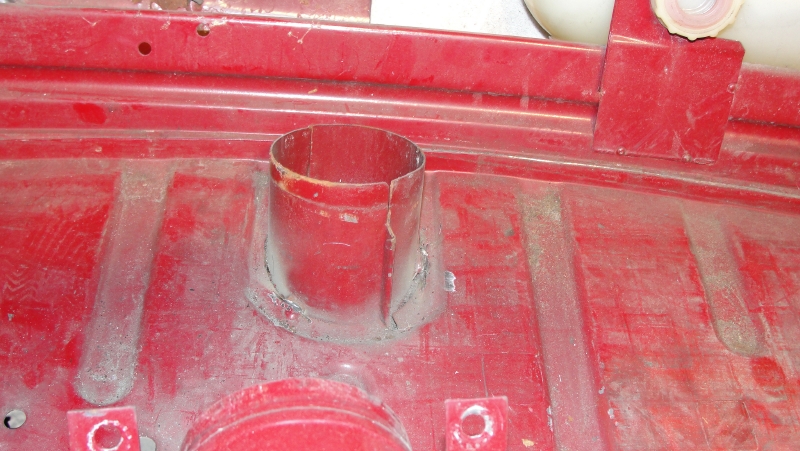

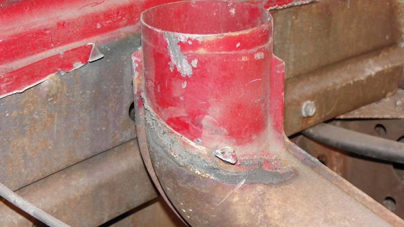

So, this next part wasn't as bad as I thought it would be. I removed the heat tube by removing the 4 bolts towards the top of the tree. In hindsight, I think I only needed to remove the bottom two.
Then I pushed the black y tube up a little and swung the top of the tree out, then pulled up to slide off the bottom tube. I didn't need to remove anything else:
After that was out, I continued to cut the rest into sections for easier removal. I'm going to have to try to chisel away at the lip section or I think I might just grind away at it.

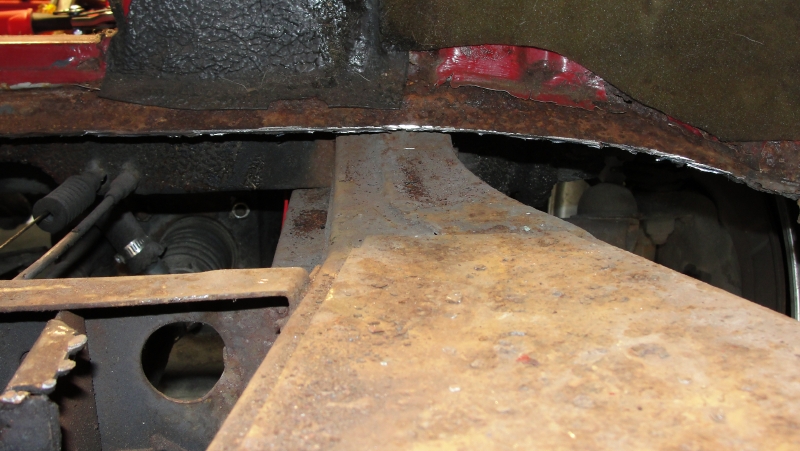

Here the important piece. I tired to preserve the area around it for measurement. The underside has the bracket and the rubber stopper for the brake pedal arm (once again, notice the glove?):

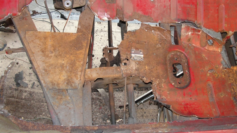

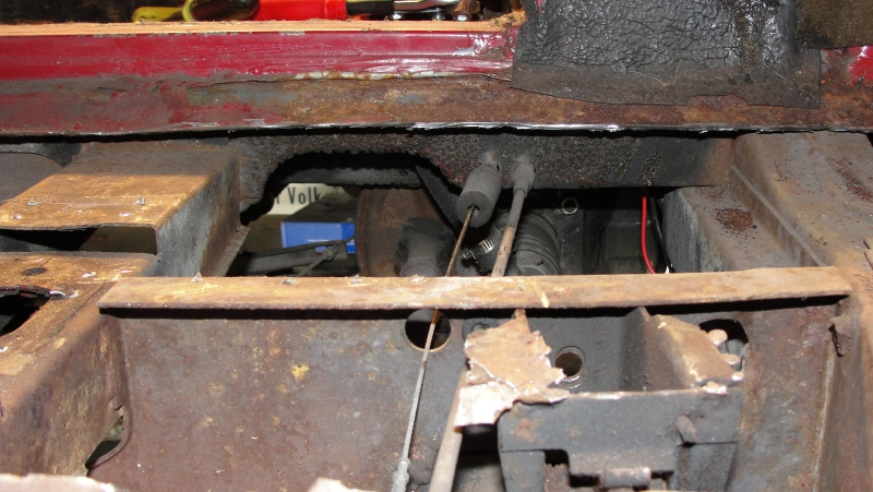

Here it is with about 99% of it cut out, which brings us to the next dilemma:
Did you see all that rust under the front? I ordered this piece but I'm scratchin my dreads tryin to figure out if its supposed to be the same piece or not:

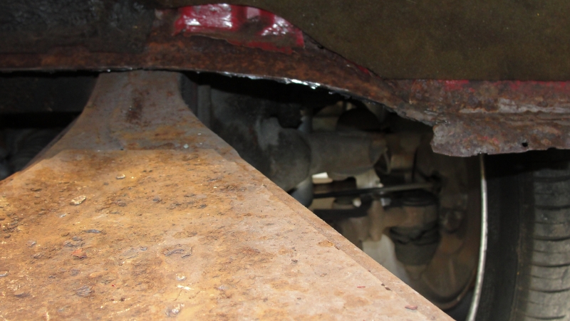

Also, the doglegs are pretty shot on the inside. I'm going to have a go at replacing these while I'm at it. Just the bottom section. I have the replacement parts but they sure as heck aren't from Awesome Mr. Gerson. They look so shoddy compared to his work.

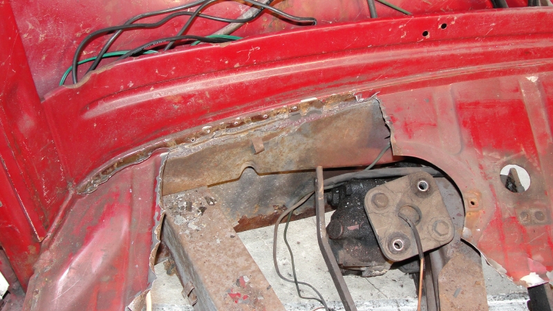

Now comes the surprise. I recently found out this bus has been hit in the front end. How did I find out? Well, I picked at a little rust spot on the nose and found this:
There's about 3 layers of different types of bondo on this section. You can also see this piece is bent inside. Must've been hit pretty hard. Look right in front of the steering box. Maybe it is supposed to be like that. I dunno but it looks out of place to me. Anyhow, I am going to assume I need to replace a section of that nose and the lower-inner section with all the rust:
