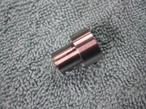

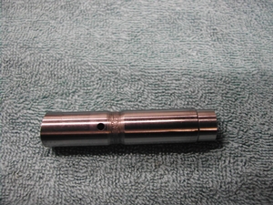

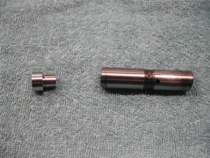

PostPosted: Thu Dec 31, 2009 11:26 am    Post subject: Reply with quote
We pulled the pushrod out of the lifter, made an insert, and we ran cut to length 1600 pushrods.
