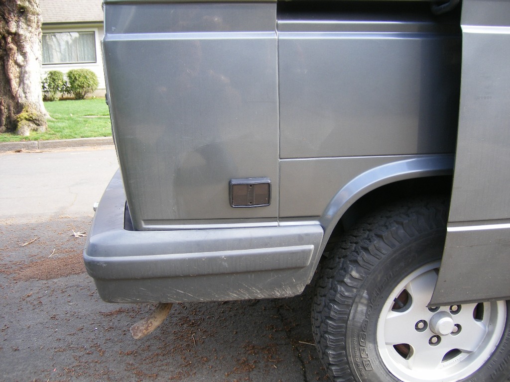

Not bad! An inch+ shorter in height though, but better load capability.

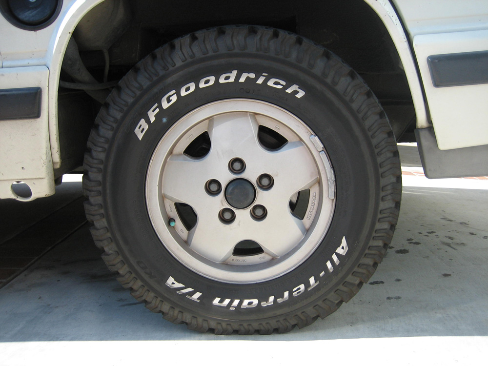

I know that I have not been here for quite a while now but this is perfect.
This is really nice for me... I've been searching for about a week now looking for tires like these:
and have come up with nothing, although I have not been feverishly searching either. Reason is I can't get them for another two weeks, but new shoes for my 87' Wolfsburg have been on the list since I bought the Van. Now I need them; I don't just "want them".
I have been to six different tire shops here locally, and all, without fail, have shaken their heads the moment that I mention that my rims are 14". I have the alloys.
I did not want to loose the stock wheels, but I did want tires like those... and that means 15"/16" rims and added cost.
Who has the best deal on the West Coast?
Ps: Thanks PDXWesty, for the pictures... and to you PW for the 500 emails. It was dissapointing to find this in my search:

Yea.. I know, sorry about that. But I was in a hurry and on the way out the door.
jacob. wrote:
Busryder, are those tires the one that are posted on the link? The 14" all terrain bfg? Those look really nice. I clicked the link, but I didn't see a price. How much?
No. These are not the tires in the first link posted in this thread, instead the pic's that I posted are of the original BFG's that were discontinued in late 08' (I think). If you look at the bottom of my first post you will find the thread that I found the tires pictured here in. I hope that these new ones are similar in appearance to the old 27x8.50R14, as they are c@nt hair close in stats.
