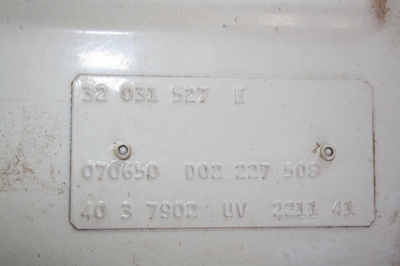

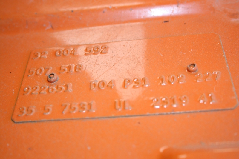

PostPosted: Mon Jan 11, 2010 1:26 pm    Post subject: Reply with quote
Here is the M-code plate from the 73 Westy.
And from the 73 Hardtop conversion....2 tone paint.
