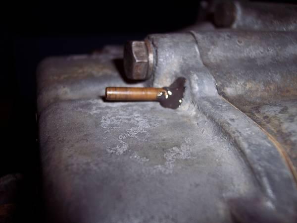

I have done that here are some pics.

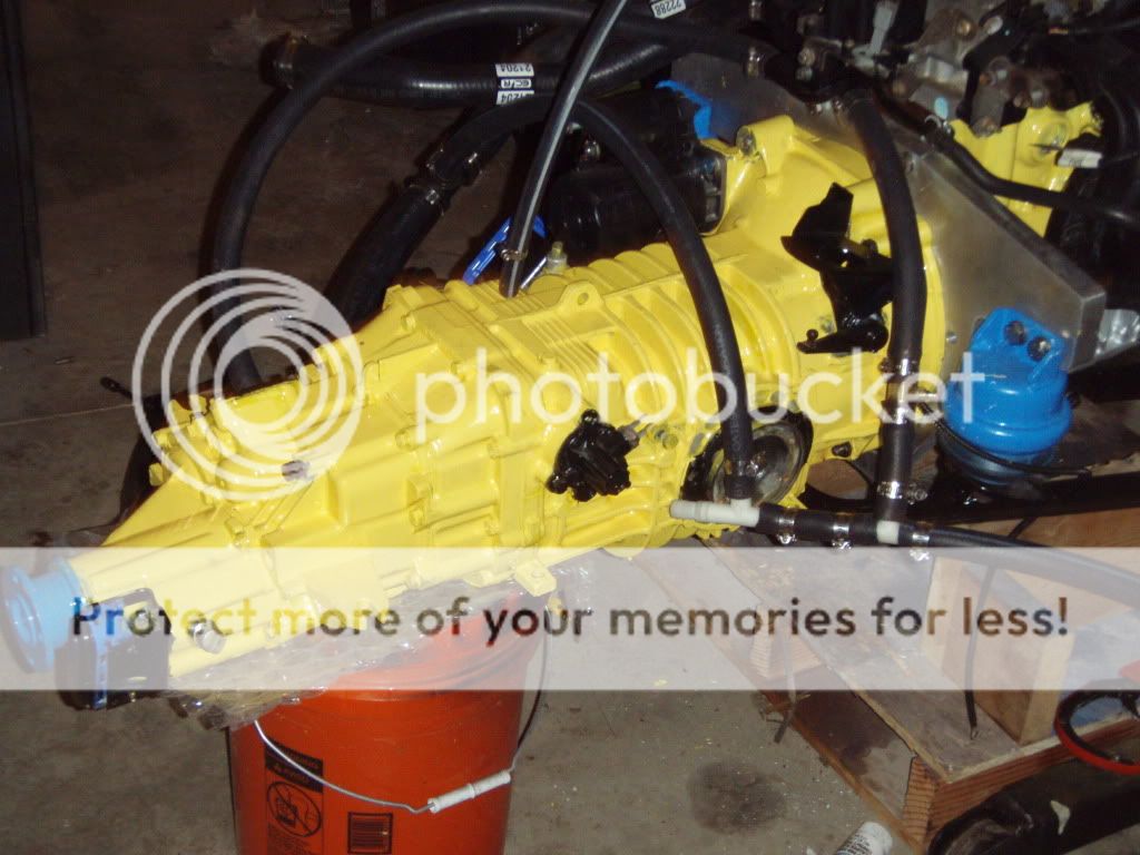

PostPosted: Fri Feb 12, 2010 8:38 am    Post subject: Reply with quote
-Lorenzo

PostPosted: Fri Feb 12, 2010 9:13 am    Post subject: Reply with quote
Yow, love the yellow! That'll be like having floodlights underneath.
So how many of these pretty gearboxes are just come back from AA Daryl? Both of the ones I have shown were just reconditioned by him.

I did modify the existing vent hole. I use a flexible hose and let it hang down like an Elephant trunk. It's been in service like this since 2012. I've had the transmission out and opened once but never saw any evidence of contamination.

So, you just drilled out the hole a little bigger and JB Welded the copper piece in ?

Yep! That sums it up.
The end of the hose hangs in front of the tranny near the mount about a couple of inches higher than the bottom edge. (sorry, no pics) Seems to be working just fine. I've thought about installing one of those simple in-line fuel filters. The tranny does breathe with heat-up and cool-down cycles.
