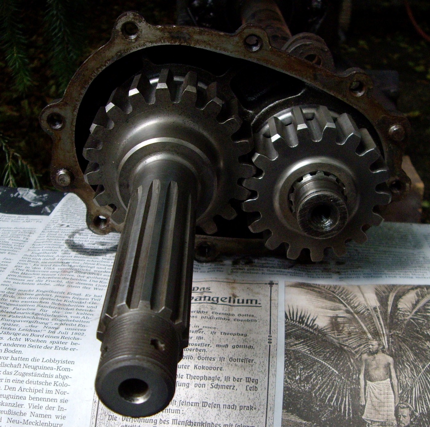

I've searched the forums and parts catalogues but couldn't find any reference to the small nut tranny stub axles (19 teeth) and matching upper gears (17 teeth) I bought at Hessisch Oldendorf last year. These give a RGB ratio of 1:1,12 as opposed to the common 1:1,39 (18/25 teeth) and 1:1,4 (15/21 teeth) ratios for 55-63 busses.
Any information as to whether this was a factory option would be much appreciated!

Unless I'm missing something, your gears don't match the parts book

the shape of those gears is unlike anything I have ever seen inside a reduction box. and I have had in my hands BD reductions, early small nut, late small nut, little big nut, big nut, and alpine gears. they are not listed in any of the dozens of parts lists that I have seen from '55-'70s.
my questions are who machined those, how long did it take, and what harness steel did they use?
how much did they cost?
i agree. i don't think i've ever seen that marking stamped on a gear either (back of upper gear).
the only thing i can think they might be (other than some weird aftermarket or someone making them) is some kind of military Thing gears?

Who made those?

im sorry but im not good at math what does this gear configuration amount to

I'm afraid I don't know - that's what I'm trying to find out. What I'm quite sure of, however, is that they are not a recent reproduction or aftermarket kit as they show some surface corrosion marks which indicate that they are NOS. Whether the hardness of steel is correct only time will tell, I guess.
Well, let's say they were not exactly cheap, but I knew right away that they were something special and probably pretty rare.
Theoretically (rolling resistance, air resistance and lack of engine power left aside) the top speed in each gear should increase by about 25 percent.
I've asked several split bus experts here in Germany and one of them claimed that there was a lower reduction gear ratio option for flat regions and/or busses that never had to carry heavy loads. But if there was such an option, then why isn't it included in the parts catalogues and M-code lists?

Nows the times to get the specs measured on those gears.
It sure would be a nice option ot go with that configuration for a RGB box for those of us i nthe flatlands, that want speed but want originality look.
Can we convince you to get the specs drawn up by a machinist and then maybe someone would be interested in a pre purcahse run of these - of course everyone would want to see what the price would be for a set.
Its be interesting to know if they were an option perhaps they were made out of Germany (i.e south africa or australia - true flat landers)

My guess is that they were small nut prototypes and the engine couldn't keep up so they never went into production. Now with ga-ga motors they would be a small nutter's nirvana. It's like the Holy Grail of the RGB keepers.

http://www.thesamba.com/vw/forum/viewtopic.php?t=294439&highlight=reduction+gears
http://www.aircooledvwsa.co.za/viewtopic.php?f=4&t=9375&hilit=reduction+gears&start=15
try the fourth post down might give some answers
prototype mostly assuredly
vw prototype not likely

that seems to me like a fairly pricey en-devour for a one off. how much did they cost you? where did the person before you get them from?

I want a set. asap! Need to pull these off, ship them to weddle or ppg and have them copy them. Man thatd be so sick.

I know, I really want to know the history on these things.

They are from a split ambulance.

Those look pretty beefy. Am I wrong or do the tips of those gears look thicker than others I've seen? Whenever I see a chipped tooth on an RGB gear it's usually only the tip, and these gears appear thicker. Would be nice...
