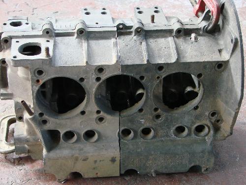

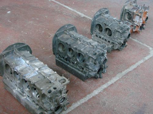

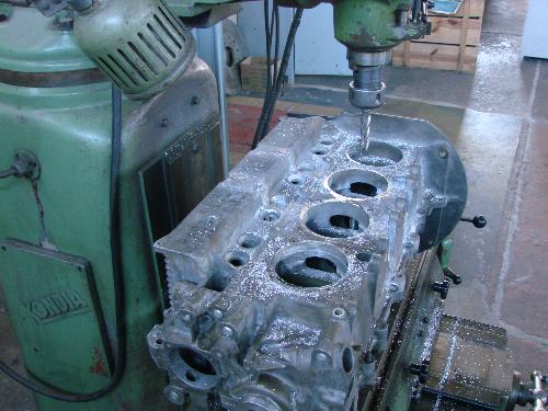

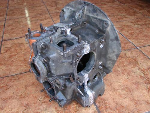

Hi, hope you guys enjoy...
these are some prototypes being made here in Sao Paulo, Brazil by Chico-Biela...
Nexus-8, eight cylinders:
Nexus-6, six cylinders:
Nexus-2, two cylinders:
Origin of this milling machine is some how connected via the Volkswagen Karmann-Ghia of Brazil... This plate is a good omen for engines prototypes (chico's words)

The 6 and 8 cyl motors would be much easier with Type 4 heads.

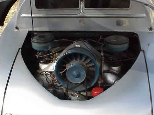

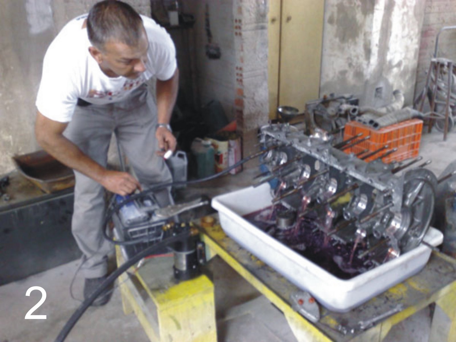

There is one 8 cylinder engine build and running by Mestre Joca (Joaquim) in Brazil...
here are the pictures of the Engine called "JAMARO" 3000cc (2x Stock 1500cc):

cool what about just modding a casting

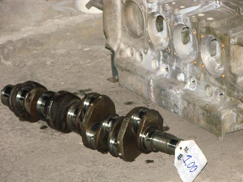

How do you get a suitable crankshaft? Tell me it's not 2x crankshaft welded together.
No, it made in one peace... billet steel (SAE 4340)

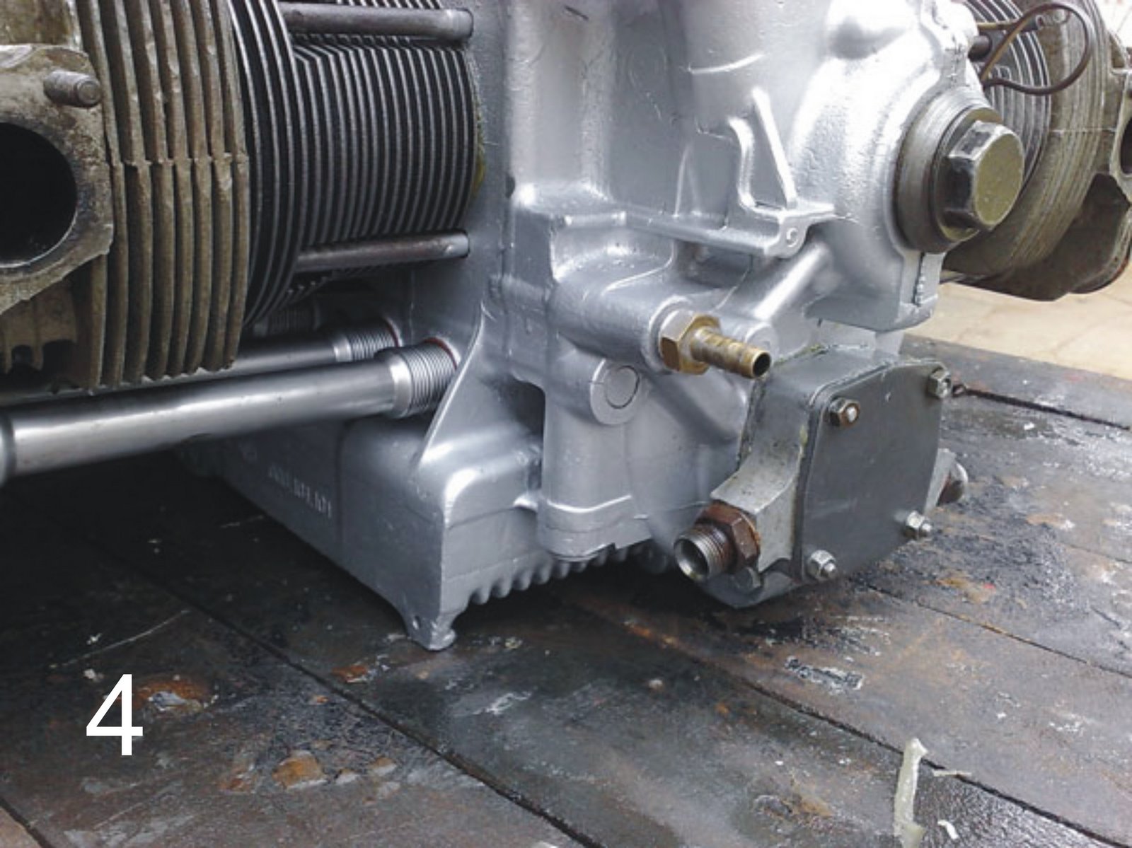

PostPosted: Sat Feb 13, 2010 10:08 am    Post subject: Reply with quote
BTW, this engine uses a electric oil pump for lubrification.
After more than 30 triggered and accelerated the engine, it was found that the characteristics of the VW engine, all the oil returns by gravity to the crankcase and valve tappets.
Just when work is linked with poor lubrication, because the ducts are longer and demanding. Which causes premature wear of bearings and connecting rods

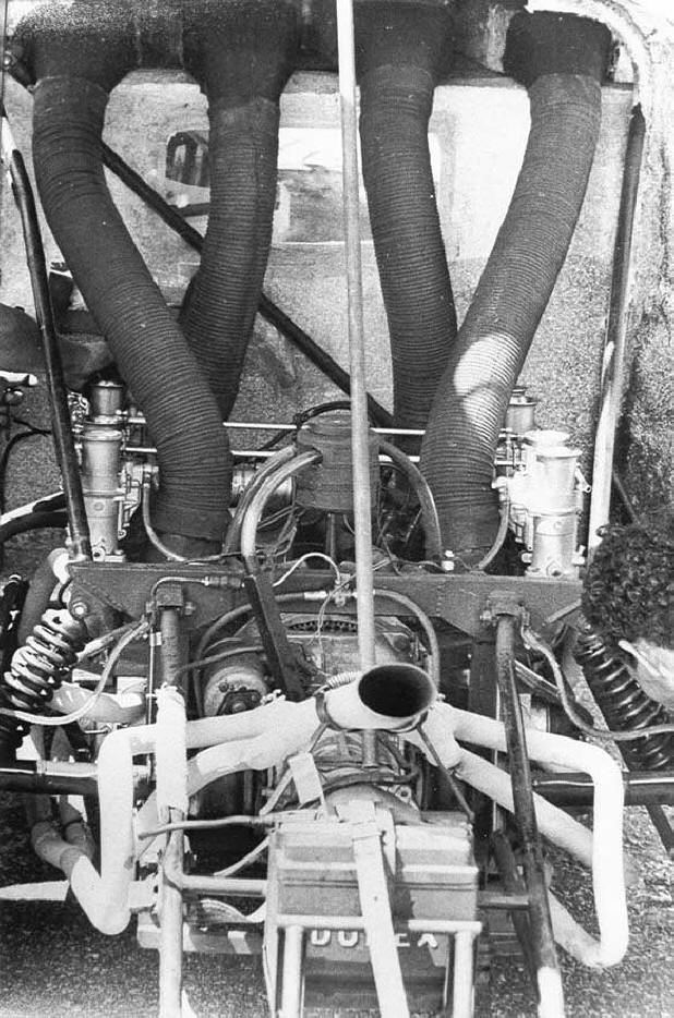

Luftgekült wrote:
An 8 cylinders type 4 has been already done in Sweden....
Back in 1969, Brazilian Formula-1 racing car driver Emerson Fitipaldi along with his mechanicals developed a 8 cylinder boxer racer car called Fitti-VW or Fitti-Fusca.
Using Okrasa kit, engine had 4400cc, roller crankshaft, four Weber 45. Metanol as fuel generating 400hp.
The car, painted orange with a white side stripe, official painting of team Fittipaldi, run for the first time at Interlagos in November 1969. The fastest time was with an Alfa Romeo P-33, V8-powered 2-liter: 1m.28.8, in second time was a Ford GT40 in 1m.29.8s. and surprise: the Fitti-VW, with Wilson Fittipaldi Junior, was third with 1m.36.3s.

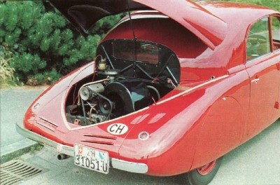

Also, Aircooled 8 cylinders has been made back in 30/40's .. TATRA or TATRAPLAN
(T77 with a V8 de 3000cc).
