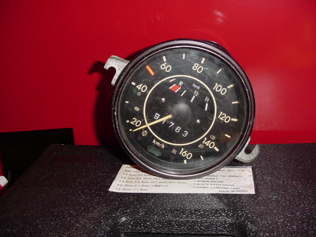

Thanks. Will need some tweaking I'm sure. I took the speedo out of my beetle and photographed it. Here is the original.
I used a ruler to get the measurements straight on the photoshop document.

you need to match the face with the type of speedo
ie a 100mph speedo needs a 160km/h face where as the 90mph would need a 145/km/h face
keep a look out on aus ebay and i think some of europe had KM/h speedos too
they come up on ebay a fair bit here

I hear what you are saying and thanks for the tip. I'll be changing the speedo as funds allow. Priority is to get this car through the test within a 10 days (or I'll be charged again!). It only failed on not having kph on the dial. Grrrr.

Well here is the first test version. I'll need to tweak it a little to fit at the top, but even if I do say so myself it looks pretty good. I'll do a decent matt colour print of the final version and if it works I'll send the post the image for whoever needs it.
Without glass in.
With glass.
I reckon it should fool the guys at the test station. I'll go rush hour. Wink
