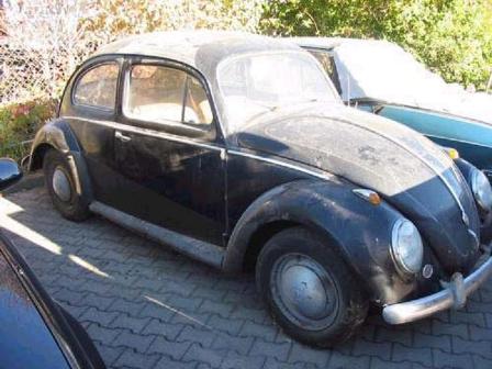

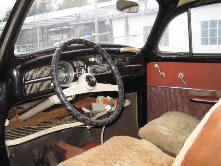

I thought of sharing with you the story of my black 1958 bug.
I bought this export beetle in 2003 near Stuttgart, where it sat in the back of a workshop of a local audi dealer since 1992. It looked like a real barnfind bargain, but turned out to be in need for a full-blown restoration soon.
I didn’t have the skills, time or money to do this, so the bug had to wait for another three years until my brother and I disassembled it in late 2006.
We then started the restoration of the car in my parents little one-car-garage.

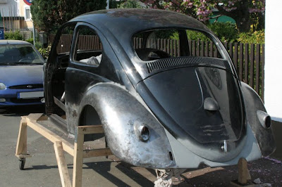

Next step was to start with the body
and to fit in the new heater channels
We replaced the complete rear section
and all other typical areas in the rear section and most of the front part

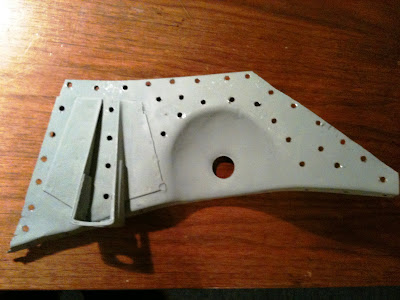

a big challenge were the enhancment parts of the inner rear wheelhouse because I did not want to use the replacement parts.

I was really busy the last nights, so here's a mid-week rear luggage compartment update for you Very Happy
Check out the blog at Arrow http://black58.blogspot.com/
From
to
cheers, Mario

Finally, the "old lady" has got a pretty new butt - like it was when she was young Wink
Slowly it reminds me of a car again ... remotely Wink Wink

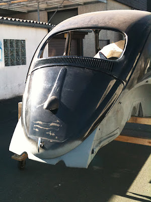

PostPosted: Tue Apr 26, 2011 12:42 pm    Post subject: Reply with quote
Got the back pretty much completely finished. Woohoo Dancing
From this point of view it almost looks like a car again Very Happy
Now off, to get the front fenders finished as well
