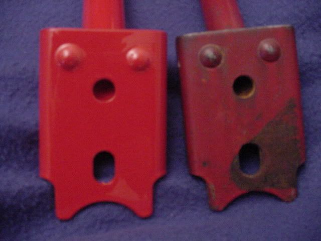

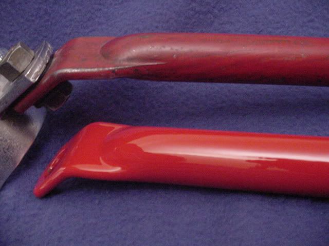

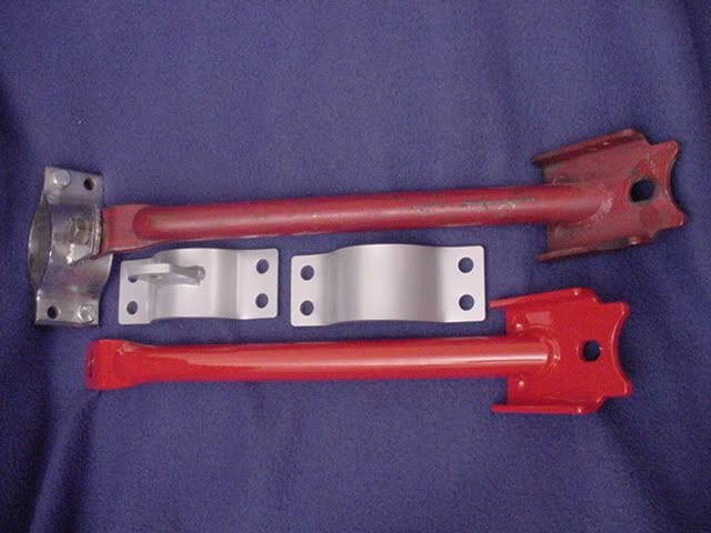

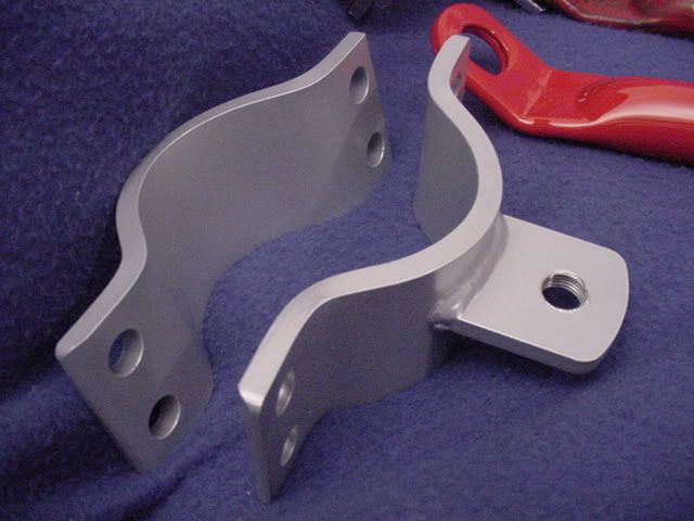

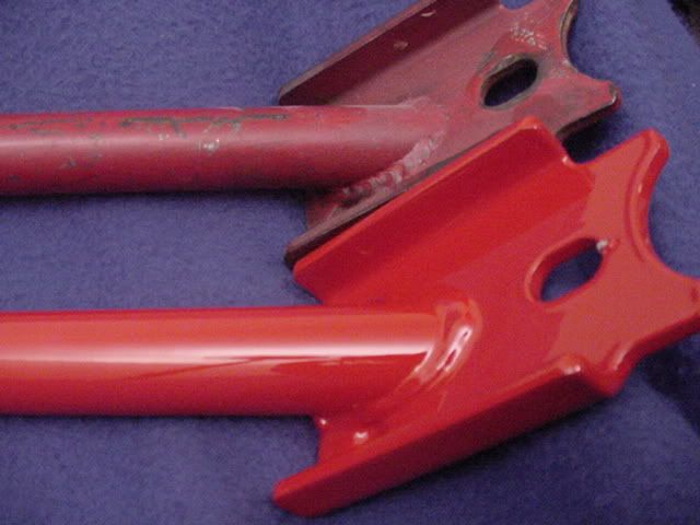

I decided to take on a project for myself and some friends to see if I could accurately reproduce the rarely seen or heard of Superior Control bars. I believe they came out rather nicely. They are powder coated red and silver and I use all grade 5 & 8 and class 10.9 hardware.

Looks dead nuts. The clamps need to be chromed though. What are you using for bushings between the clamp and the arm?
I thought about getting the clamps chromed but the quality of chrome sucks now days. The originals rusted under the car because of the cheap chrome job they received. Heck I've seen NOS sets with rust right out of the box. So I had them powder coated for durability. The bushing is a military spec grommet. I don't recall the durometer rating right now but it's similar to the rubber of a car tire.

I had all of the parts laser cut for accuracy unlike the originals that were all stamp cut and had pretty rough edges. Here is a few more pictures including a side by shot shot of mine with my original bar.
