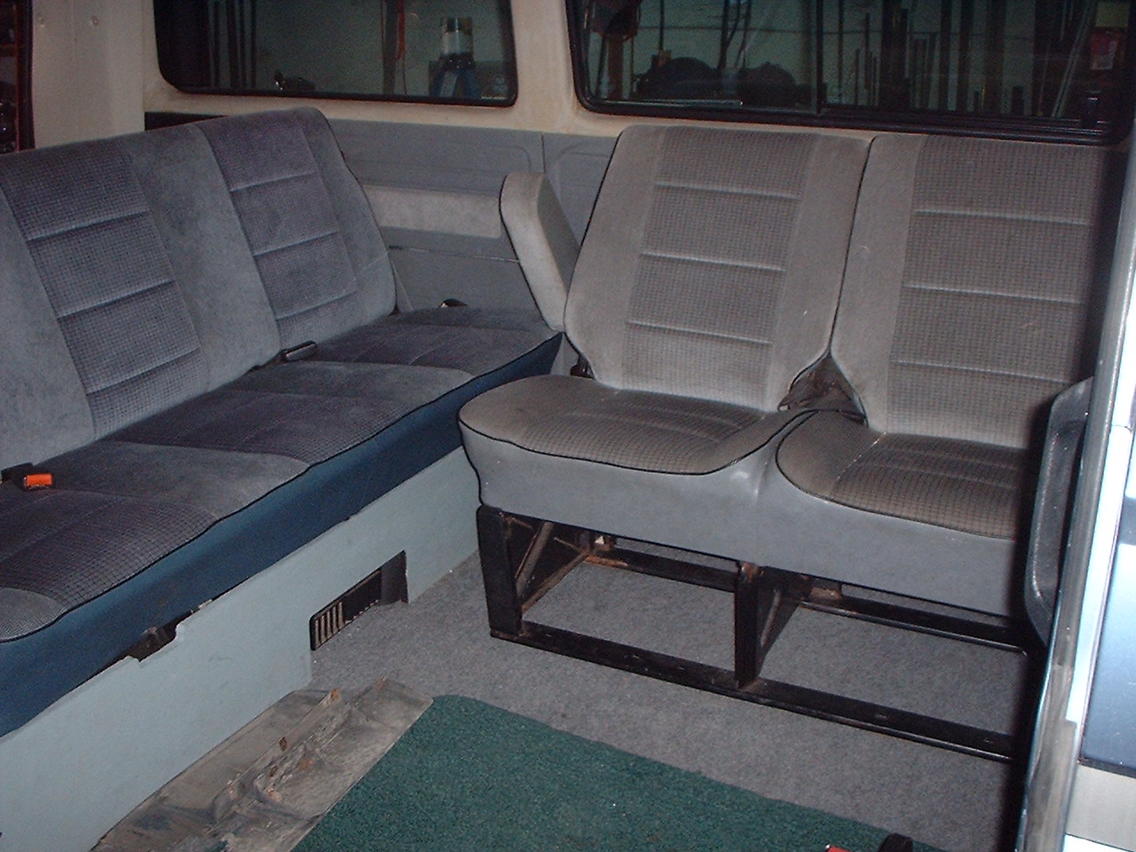

the seating is not great, 13" on dwg left and 17" on the right. the bed feature is going to have to change.
even when it is original I want to put an air mattress on top to alleviate the cushion density

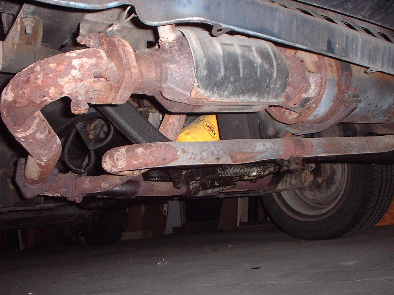

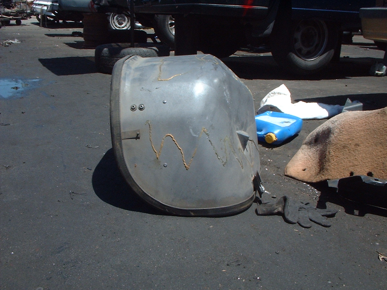

89 gl runs needed a new brain. thats a good first step after hearing the fuel pump. no spark and almost no voltage to the coil.
they must have tried to jumpstart it and fried a capacitor or..? the automatic isnt bad.
I took her to a&w for lunch and found I had a big airbubble in the radiator. so I jacked up the front and rear ends and bled
them at 2400 rpm. aired up the tires, which are almost new. I'm going for smog tomorrow. she has illinois plates. looks pretty rust
free underneath after the pressure washing. a freaky thing happened. the only guy interested in my toyota pickup shell came and
bought it today, so I can give the smog guy cash. just in time.
that cat and muffler went in the trash so it could pass smog
its funny, buying a vanagon from a girl. theres dog and cat food on top of beach sand on the decklid, and a wiped up fingernail
polish spill with finger smushes on the rear hatch in red. my cousin said "it smells like a girl in here. I threw that air freshener out
today. gotta put the grille back on tomorrow-easy.
this van is real greasy up in and around the trans area. the fluid looks nice and red. the power steering complains and gurgles
and the brakes are spongey. it mught be a little on the metal on the shoes.
she runs nice. the fuel lines were replaced too. the back door struts are good and the window rubber. it was repainted and the
slider has a bit of bondo, but I don't care. its perfect for a host vehicle.
