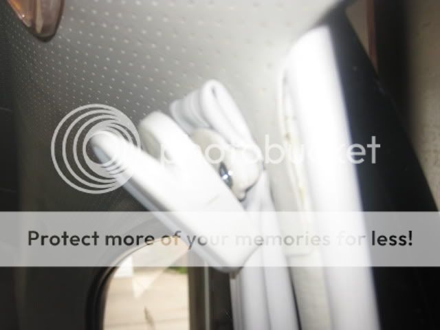

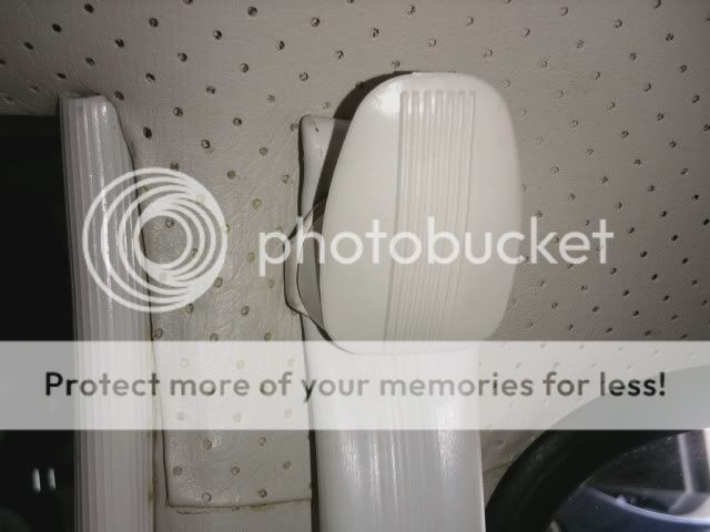

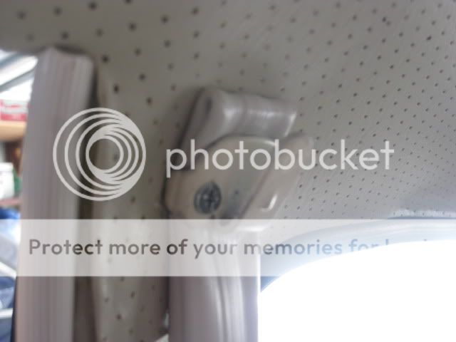

Slid into place, but it doesn't "snap"? Just sits there? Here are pics ... if this is how it is, just seems a bit, er, unfinished. Smile

You have the wrong coat hook! That is for '67 up!
You need this one. http://www.wolfsburgwest.com/cart/DetailsList.cfm?ID=113857635A

Got the wrapper, part # 301-829 from MidAmerica. http://www.mamotorworks.com/acvw?frame=1.6470
From the picture, though, looks like the 379-380 hook was sent (packaged / labeled incorrectly).
But THANK YOU for the help!
correct----- that is for late 67 onwards that have 2 vertical screws instead of 2 horizontal screws.

Parts arrived today. What. A. Difference. Now I understand your "huh?" about the snapping questions.
Thanks again for the guidance.
