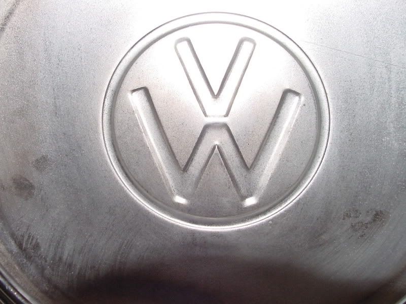

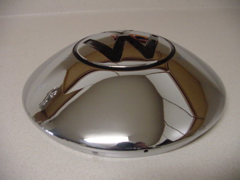

OK I am 99.9% these are repro but how can you tell just to be sure? There is only one hole shouldn't there be two? I can't find a VW stamp either.

Just one little hole instead of two in the edge is correct for such early ones but the repros are usually less sharp pressed in the logo area.

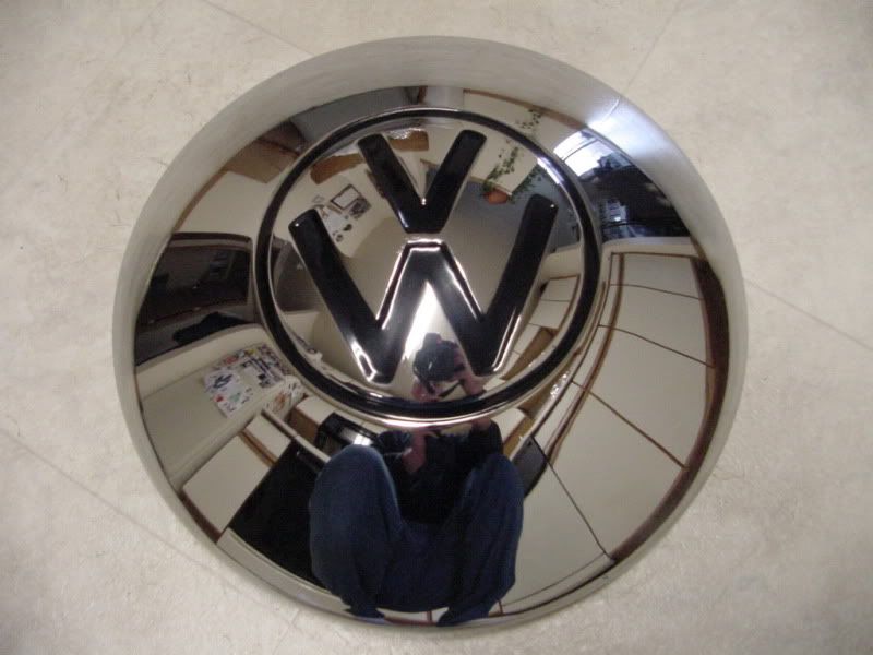

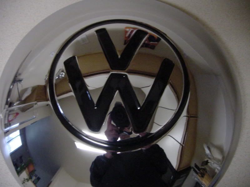

Now you got me curious, pressing appears to be pretty sharp. Hard to tell from pictures. was anyone making repro's of these in 1980?
Its been raining all week here and these two showed up at my door on Sunday Very Happy

Could you get a really cute girl in a mini-skirt to retake this first pic? Very Happy

The originals and the first run of large-logo repros (heavyweight) from the late '70s/early '80s had the single puller hole. Some of the old-timers on the site might know if these were OEM.
