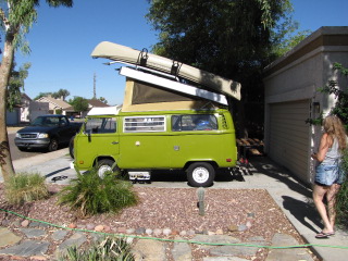

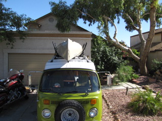

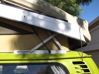

I coulden't lift my top without removeing my canoe from the top first,so I installed pop top shocks and now I can lift it with little effort! Supplier Jack Bombay (Samba User).

Am i missing something here or are those just gas struts?
Might be the go for the pop-top caravan. It just about kills me trying to lift its roof.

Yup, gas struts. Nice install!

The rack came off a Xterra. There are many write-ups on these shocks in the Vanagon forum. Use the search for poptop shocks and you'll find Jack Bombay. Order from him @ $90 a set. Lower ball joint is 7 inches measured from the end of the bracket and is 4 inches from the bar running from the top of the bus to the poptop. These are spring loaded. I got the heavy duty set. Just use caution when drilling your holes. You cannot compress them by hand, their that stiff. The brackets on the bus where they bolt to the roof are slotted and you can move them back and forth so its a little misgiving if you miss your mark like I did on the drivers side. I was off by a sixteenth of an inch and I just tap the bracket back till the ball poped in the joint. Better to be short than long. These shocks rule! One of the best upgrades you can do. After installion I could'nt believe how easy it was to open.

I went to a local salvage yard where they had many different SUV's with racks on um and chose the Xterra because of the big feet that they have to spread the load out. Just placed the rack up there, marked, drilled and bolted on. $40 bucks, can't beat that. Saddles are Yakima for the canoe to set in. Of corse it will depend on where you get one at depending on how much the junk yard thinks they can get for the rack you may chose. I shimmed the middle feet with quarter inch rubber because of the curve of the roof on the Xterra. Looks good and will last for a long time.

Cool to see how you set up the shocks on your bus!
Is it possible to drill the hole in the pop-top higher up? I see that just above where you drilled the roof steps inward, if the other ball mount was further up on that step the shock would likely hit the sliding bar part of the hinge mechanism, yea?
I just bring this up because with the shock mounted higher it would have a little more mechanical advantage over the top, but it sounds like yours is working quite well especially considering you have a canoe on the roof!
You can also use the drill bit to make the hole in the pop-top a little oval shpaed, the fender washers are big enough that you could miss by ~3/8" and the hole would still be covered.

Thats certainly another way to do it, with the vanagon kits I was wanting to avoid additional holes into the van itself so I based the kit off the rear hinge as sex drugs and rock and roll has done.

Hi Mike, To answer your ?'s No to the ? of mounting higher on the top. Hinge & shock would interfear with each other. And when the canoe is off, yes you do have to pull down to close the top. But not too much. No biggie on the doe for the Vanagon hardware I did'nt use. I'll be able to camp longer in my golden years.
