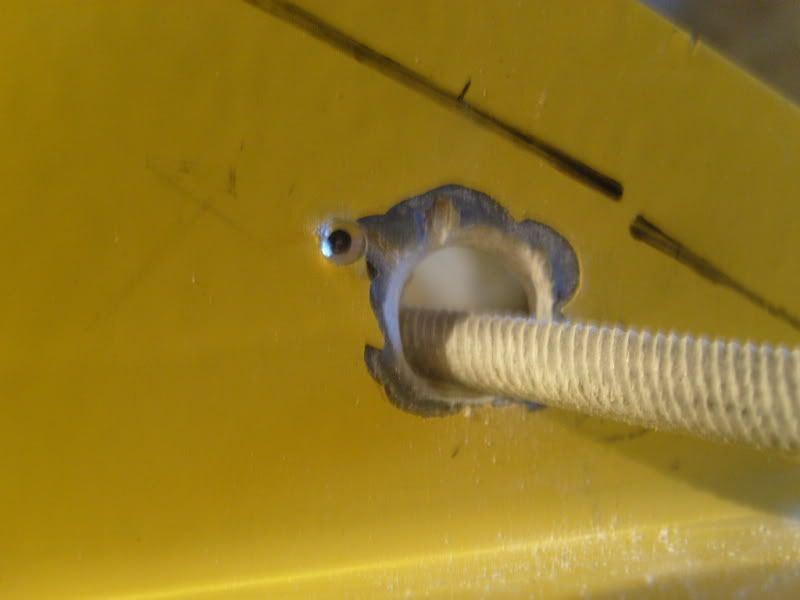

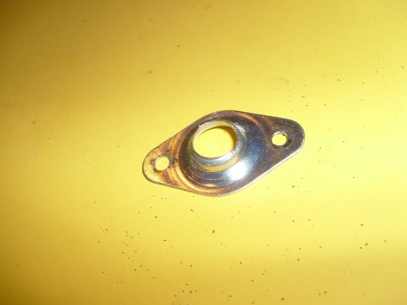

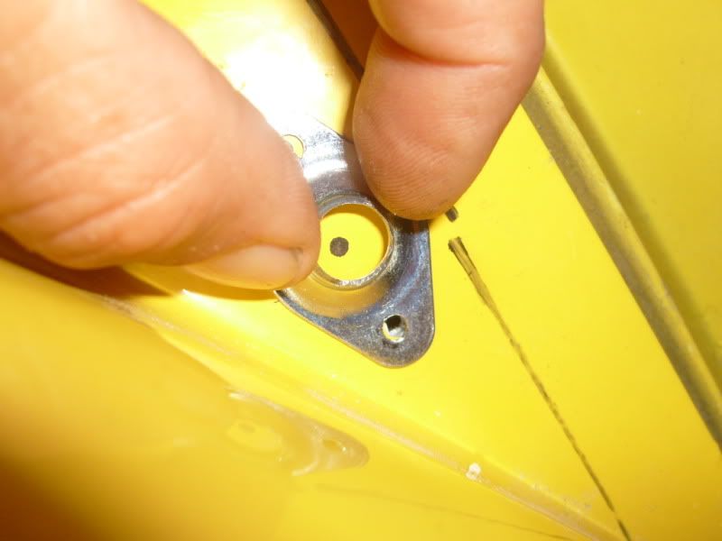

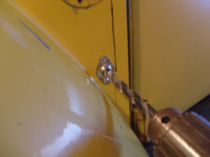

I took 1 fastener, and took it apart, so I could flip it and have the flat spot for the template.
hold it where ya want it and mark the rivet holes. Ignore the center mark, it aint needed.
after you drill the rivet holes, I rivet the one I took apart on upside down.
then I drilled right through the whole thing, back included with a bigger bit (whatever size your fastener is). This got me on center for all 6 of em, and I didn't have to have anyone hold things...

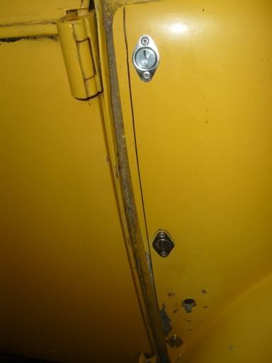

see? it lines up perfect by using an extra fastener as a guide

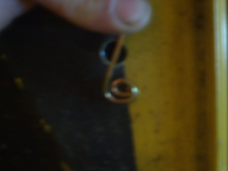

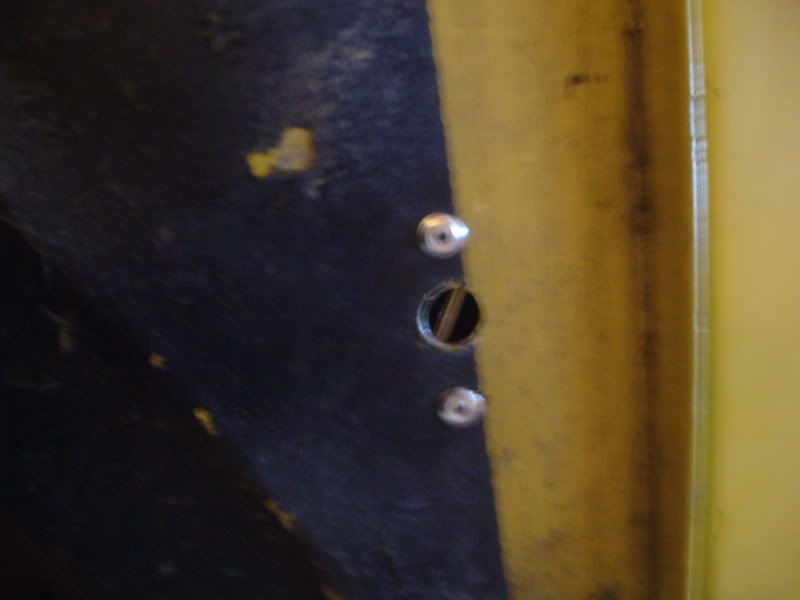

on the inner part, mark the holes for the spring backs and drill.
rivet the spring on (from the back of course)

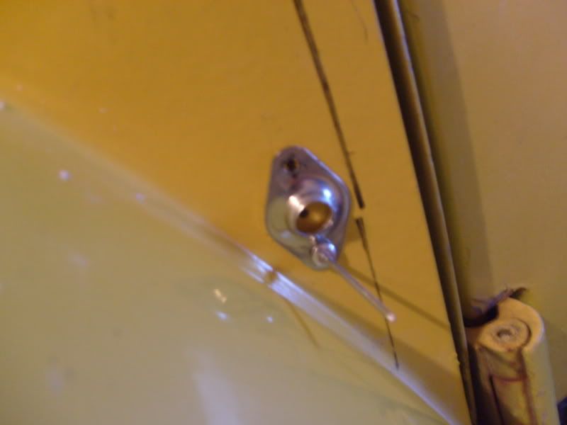

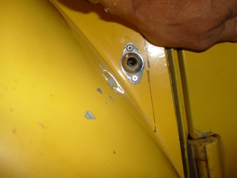

drill out the up-side down fastener rivets, and remove it. the holes are now there a lined up for the good one.
i drill the fiberglass (outer) part out 2 bit sizes bigger, and then bevel it with a roundfile. this allows the fastener to seat totally flat.
install a good fastener in the part for good and they are perfectly aligned every time.

Good idea! You can avoid installing and removing the two pop rivets if you use a pair of Clecos instead, like the aircraft folks do.

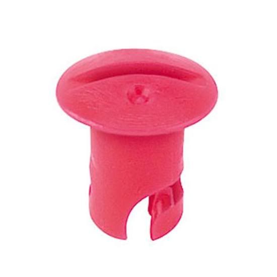

Anyone ever use these? They look just like the metal ones I have, thx.
Plastic ones:
http://www.speedwaymotors.com/Plastic-Oval-Head-Fasteners-Pack-of-10,1577.html?parentDisplayId=1572
Metal ones:
http://www.speedwaymotors.com/Dzus-Oval-Head-Fasteners,1572.html
