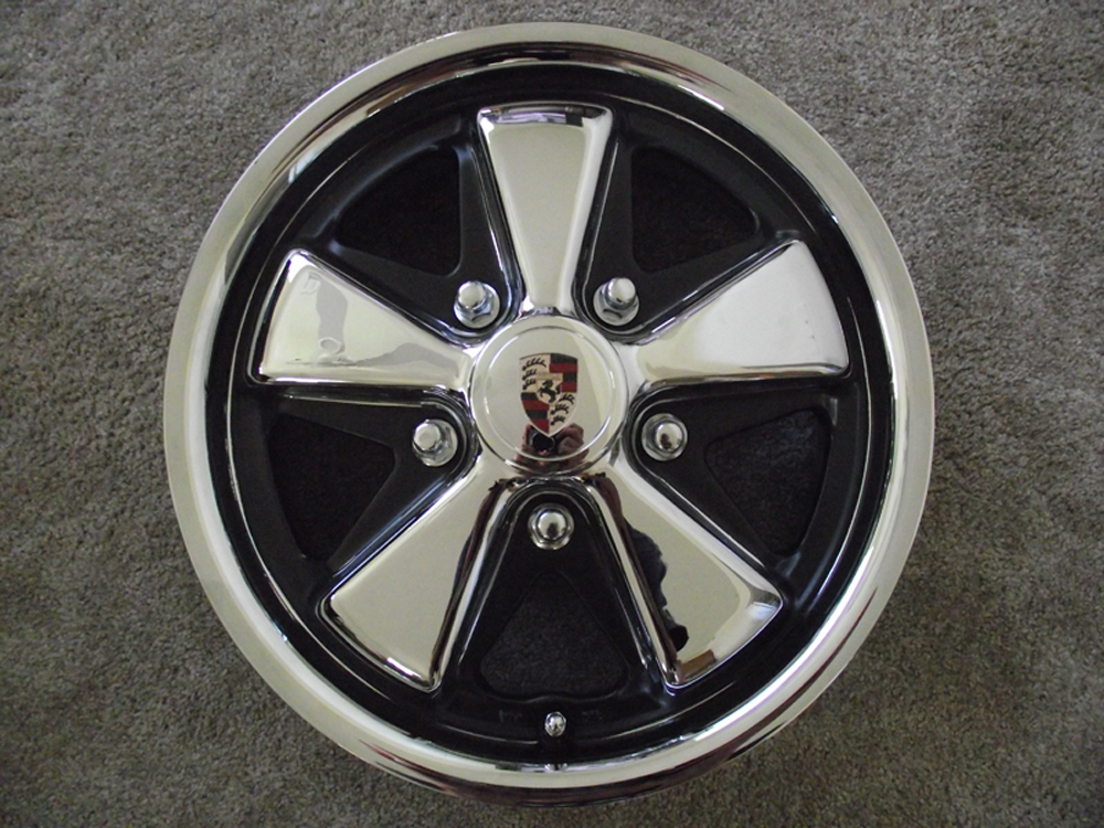

Nope. You do not need to strip the chrome. I painted my chrome Flat fours a few months ago and the came out great!
Basicly you use an adhesion promoter. It's made to help paint stick to chrome or plastics.
The brand I used was called buldog.
Roughed up the area with 80 grit sand paper by hand.
Then use the Bulldog adhesion promoter, then sealer (if it's smooth enough) I used a black sealer.
Then I used a single stage gloss black.
Sanded.
Adhesion promoter.
Black sealer.
Paint.
Done.
And DONE! Cool

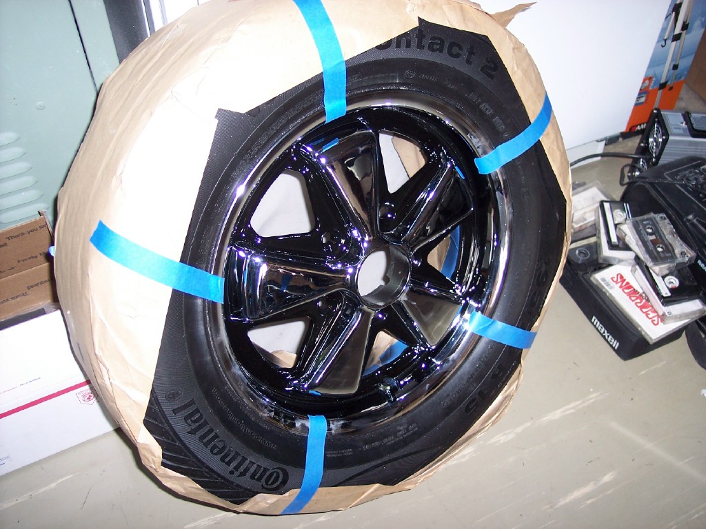

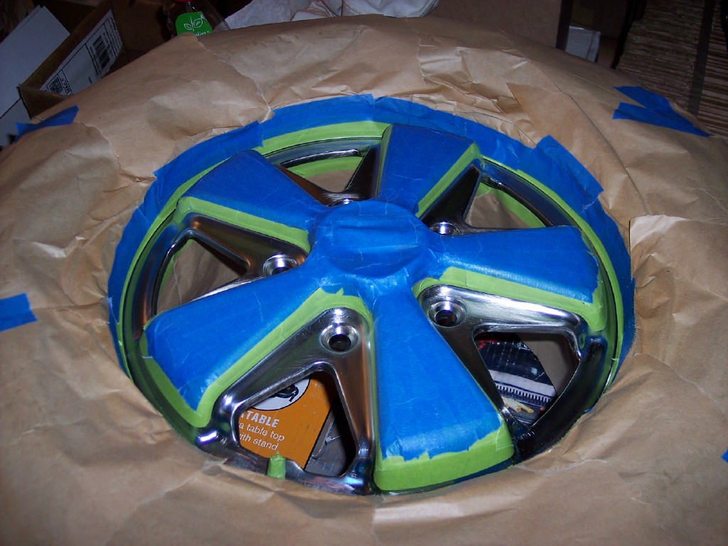

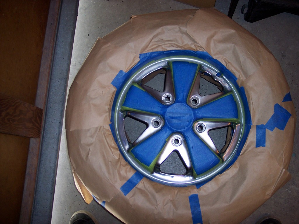

Cool, I also got Bulldog adhesion promoter and I roughed up the surface with some scotch bright pads and sandpaper. I just sprayed the adhesion promoter then layed the paint on. I didn't use a sealer so I'm hoping there won't be any adverse affects. The first rim is actually drying as I'm typing this so I'll see how it all works out once he tape comes off. Thanks for the replies,

PostPosted: Tue Aug 03, 2010 8:50 am    Post subject: Reply with quote
Great job scottz!! Are those ISP caps?
Looking for aluminum single port Kadron manifolds.
scottz
Joined: April 13, 2008
Posts: 477
Location: Bellingham, WA
scottz is offline
PostPosted: Tue Aug 03, 2010 2:32 pm    Post subject: Reply with quote
Thanks! Yes they are ISP caps, great product!!

I've got the chrome center caps painted (pretty tedious work) and one 4.5 chrome rim painted so far with the others to follow soon. I used a slightly more flat black to paint the rim since it appears most original Fuchs were detailed in a dull black. Thanks again for the help,
