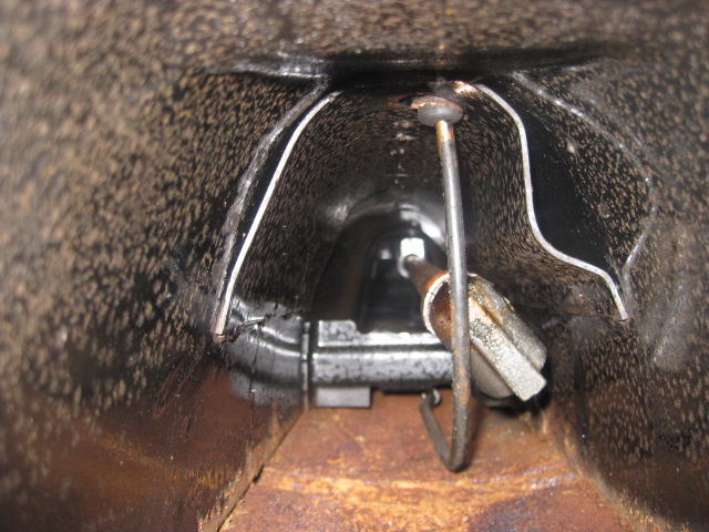

Does anyone have any pics or links to pics of what the VW Beetle tunnel looks like on the inside? I'm wondering where all of the brackets for the clutch tube are located, how high the E-brake tubes are, where the shifter rod runs, that sort of thing.
I know that I could pull everything apart, just start chopping, and learn through experience, but a handful of pics of where things are located before I begin would be a BIG help ! ! Even partial pics of either end or already chopped up spines/pans would be helpful.

PostPosted: Tue Sep 14, 2010 12:36 pm    Post subject: Reply with quote
BL3manx continues to impress, Glenn must have a doctors scope or something, I had to use a sawzall to answer the question. Laughing
Hope the extra angle helps answer your needs.

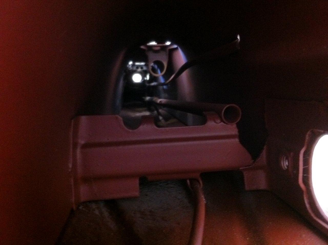

PostPosted: Sat Oct 02, 2010 12:41 pm    Post subject: Reply with quote
Here's a pic at the front of the tunnel. Sure would like to see Glen's pic with the shift-shaft out of the way. I think I've got an idea what the bracket originally looked like.
