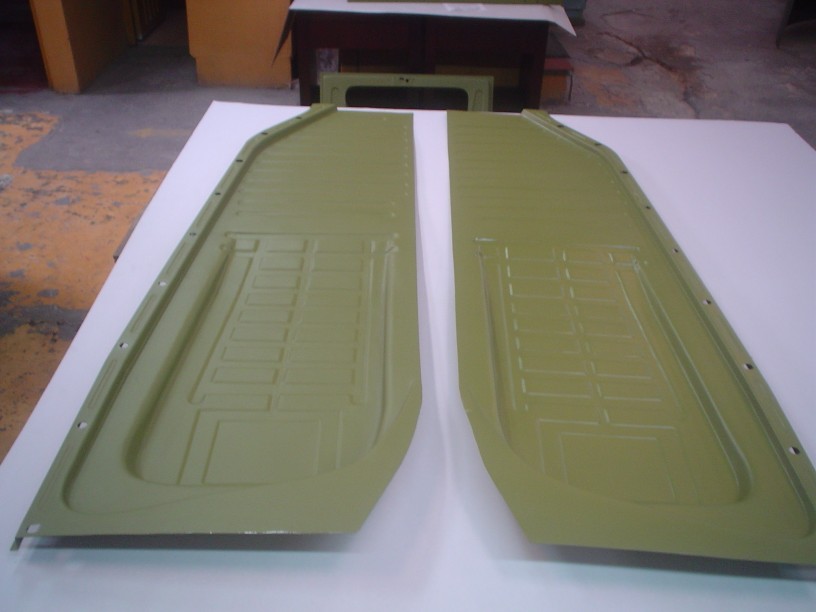

Saw this is the parts gallery.
Says it's their first try.
Looks pretty damn good to me.

I only see one detail that looks incorrect.
The little indentions I have have circled. I don't believe they came to be until '56 when they added the floor mat posts to the pan. I might be wrong. They might have come to be in '55 but my late '51 does not have them.
See the pan below.
I can't wait to buy a pair.
See the pan below.
Is it just me or does it look like the Funky panel is the inverse/reverse of the passenger side pan?

PostPosted: Wed Sep 29, 2010 3:25 am    Post subject: Reply with quote
the second black and white photo is one that I photoshoped to show the difference between later(left) and earlier (right) so yes your observation is correct but the left one is not correct until '56.

PostPosted: Wed Sep 29, 2010 3:47 am    Post subject: Reply with quote
Ok, so the funky panel is for the left hand side on Split - '55 then?

splitjunkie
Joined: April 04, 2006
Posts: 4216
splitjunkie is offline
PostPosted: Wed Sep 29, 2010 6:47 am    Post subject: Reply with quote
David wrote:
yes.

PostPosted: Wed Sep 29, 2010 1:38 pm    Post subject: Reply with quote
we are about halfway done with the first die for these floors... the ones in the pic, we hand made for a gentleman that needed these ASAP......I have a set of OG mid 50s complete floors that some very helpful people helped me score.......we are doing the floors, the front fenders, the rear fenders and the heather channels as we speak/type........thanks for the feedback guys, I need as much of it as possible........ Very Happy Very Happy Very Happy Very Happy

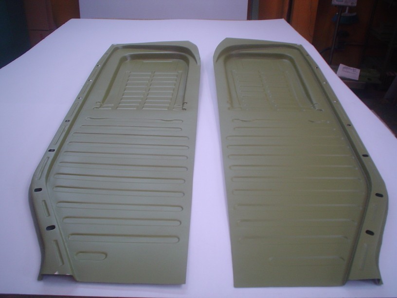

here is some eye candy......... Very Happy Very Happy Very Happy Very Happy

Gerson - when do you think these will be completed?? I'll need both halves. And I do agree, however, that the little indendations/bumps are not correct for the 50, 51 or 53 zwitter I own, so I'm thinking that must be something from a later design.

The indentations look like they may be in right place for the seat clamp bolts. They look like the same place in my Standard. There are no seat tracks, only 4 bolts for each seat to hold the clamps and the clamps hold the tube under the the seat frame. This was done so that parking attendants could not adjust the seat. Just a guess.
