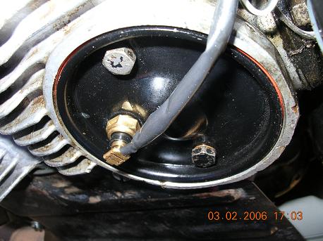

Taco plate is drilled and tapped with a nut on the back side of sender, should be secure enough. should gasgacinch or aviation sealant be used on the threads. worried about oil seepage

It works the same whether in FL or AZ. No matter where you put it, it's only for trending your engine temp. It will show you if it's running hot or cold or somewhere in between. And it'll show you if it's running normal or not. You'll have to get used to watching it and see what it is telling you. The numbers might not really tell you the whole story.
Permatex Aviation would be good. But the threads are on the inside. Your leak would be on the outside. It's the copper washer under the head of the sender that probably needs sealing.

Locktite Red for me on the threads. No leakage. That is the place you want it.
nathansnathan
Joined: April 14, 2008
Posts: 1671
nathansnathan is offline
PostPosted: Tue Oct 26, 2010 8:25 pm    Post subject: Reply with quote
Loctite red is the high strength, supposed to be non removable? Wouldn't blue be better?
I've used teflon, but mine has pipe thread.
Randy in Maine
Joined: August 03, 2003
Posts: 34890
Location: The Beach
Randy in Maine is offline
PostPosted: Tue Oct 26, 2010 8:30 pm    Post subject: Reply with quote
Blue, red or teflon all work. No issues.

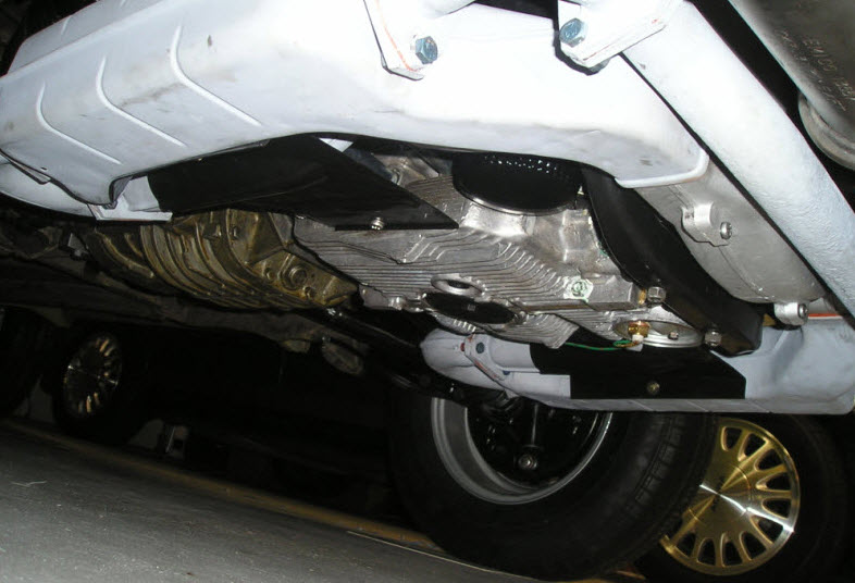

One of my winter 'to do' jobs is fitting a VDO oil pressure gauge, voltmeter and tach, all 52mm in size, in a mounting plate for 3 gauges. I decided against fitting oil temp, basically as the hotter the oil gets, the lower the pressure and vice versa, so a suitbale pressure gauge can tell you a lot about your engine.
However, I did research the oil temp gauge when deciding what aftermarket instrumentation I was going to go for (keeping it minimal at 3 gauges), and if I was going to fit one, I would follow what Ratwell has written here:
http://www.ratwell.com/technical/VDOGauges.html#ot
That's including sourcing the relevant 914 parts, including the air deflector to help stop external air cooling the taco plate and leading to your sender transmitting erroneous readings to the gauge.

Quick question about the taco plate location - I drilled in a taco plate and installed the sender, took my plate off and when I went to install the one with the temp sender, the nut hit the lip. I put the nut as close as possible to the center bump in the plate while still allowing sealing.
I can reverse the plate 180 degrees, but there is an oil passage towards the front of the engine that the nut would be in front of (its a big nut, the only one I found locally was quite big).
Should I grind down the nut so I can install it on the rearmost side of the engine?
Will having a big nut in front of that oil passage on the front side cause problems? It won't block it entirely (obviously) but I don't want to mount it there if it will restrict something that shouldn't be restricted.

504 wrote:
SG - Do you have the sender installed closer to the front of the engine or closer to the rear?
this is the best I can give you right now
ignore red arrow.

Thanks. That answers my question. I was just hesitant when I took my plate off and saw that the nut I was putting up there was going to be right in front of that oil passage. I guess it does not matter here.
