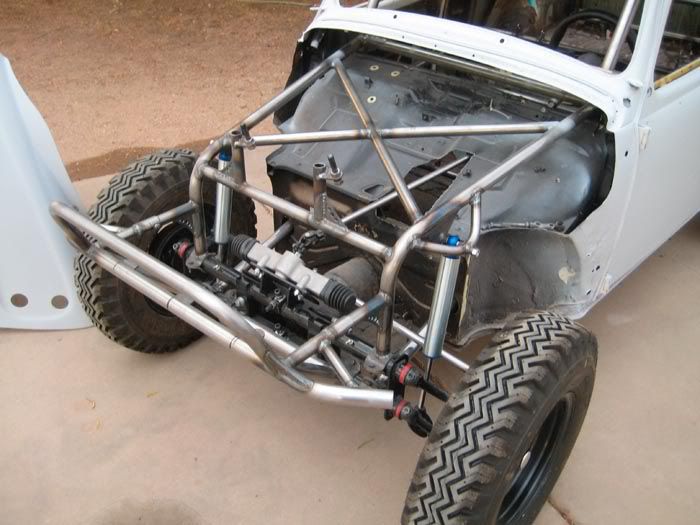

PostPosted: Mon Dec 27, 2010 1:45 pm    Post subject: Reply with quote
This is what I did...
There is a bolt on kit that goes from the beam to firewall on top, and beam to pan on the bottom... I'm sure CIP1, Chirco, etc all carry the kit.

PostPosted: Mon Dec 27, 2010 1:59 pm    Post subject: Reply with quote
thanks Az-bug, the pics help a lot. any bolt on kit i would have to mod for my personal use.
