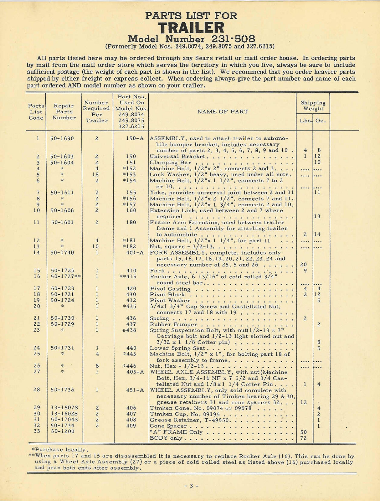

Wheel bearing assembly=
Bearing sub assembly part #s as follows=
#29 on owners manual, Cone (actual roller bearings) part #09074 Found it at Auto zone, $33 for two.
#30 on owners manual, Cup (inner race) part # 09195 Bought 2 (each from seperate sellers) for a total of $12.XX off ebay shipped.
#31 on owners maual, Grease retainer (outer seal) Rotary Shaft Seal, SKF Part #11615, $12 for both
I have not yet installed this bearing, but intend on doing so. I have both a steel one piece wheel and a aluminum two piece wheel in the garage at this point, and have disassembled the steel wheel completely, and can say that both aluminum and steel wheels have the same inner and outter diameters for the bearing
*Edit, changed source for cup, and and cone*

hey i have found the parts list that lists the timken Bearing sub assembly part #s as
timken cone # 09074 or 09078
Timken cup # 09195
grease retainer #T-49550
it lists the pivot washer as just that. a 3/4 washer..i will be taking mine apart and looking at mine but just having a washer in there with grease sounds like it works.I have found several oil impregnated thrust bearings at MSCdirect.com. I guess if you wanted you could use a thrust bearing in there but don't know if you need that much.
this all comes off the Allstate Wood trailer Parts list, model # 231-508 on singlewheel.com from a guy there named Burke
I cant load them here as they are HUGE. but they have a good illustration of all the parts (including the hitch assembly)
it is on the literature page. about half way down and 2nd under the red VW Smile

[quote="lnrbry"]hey i have found the parts list that lists the timken Bearing sub assembly part #s as
Timken cup # 09195
quote]
I see two parts have #s that dont match so I did not put them in the sub assembly parts list, I fear maybe they have changed #s or something you never know, or they could be for another company. I have also seen the 49550 number on my grease seal so I do know it is correct and will work.
