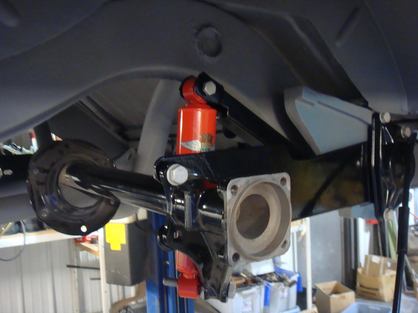

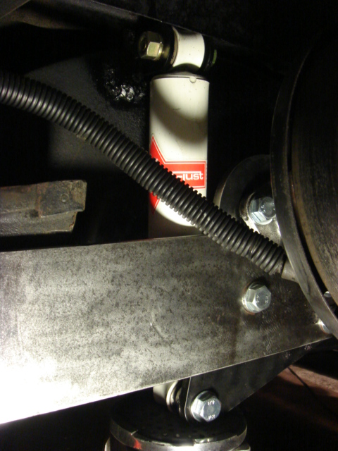

barnduude
Joined: July 22, 2008
Posts: 91
Location: belgium
barnduude is offline
PostPosted: Mon Feb 14, 2011 2:01 pm    Post subject: Reply with quote
alo,
here is how i did it Cool
there are others pics in my gallery
grtz to all.
