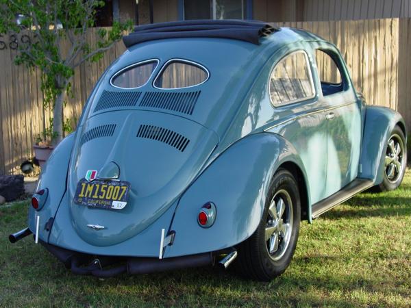

i have owned several gulf blue cars (one of my fav colors on a bug) and the notch does not look like gulf blue to me. and the scans of the paint chips are way off too.
this is my car and it is painted Gulf Blue with PPG single stage mixed off of the L390 code number. depending on the lighting the color does seem a little different. so the notch could just be lighting that makes it look turquoise to me
heres my old 63 in gulf blue
