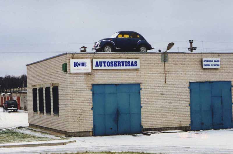

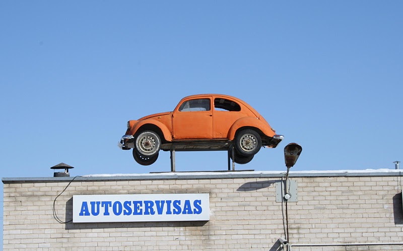

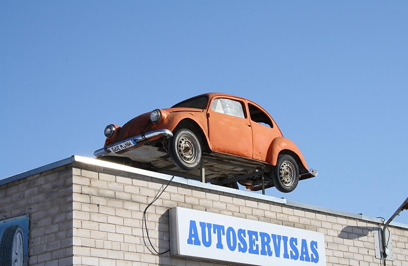

From the people who brought you the incredible story of finding the world’s second oldest VW beetle, comes another KdF find. Yes, our favourite Lithuanian KdF hunters have done it again and got their hands on another wartime VW.
The way it looked circa 2000
And just before rescuing.

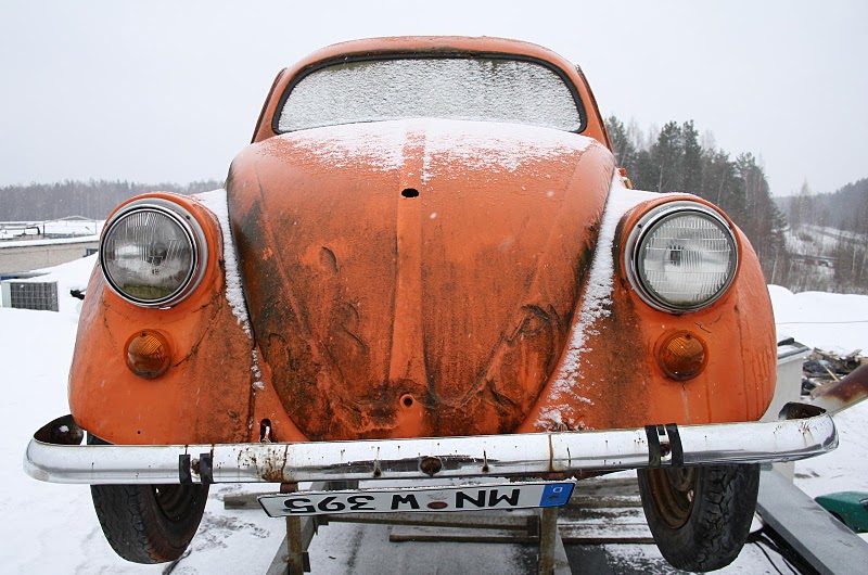

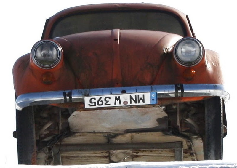

Just like the VW38, the roof-top KdF is a bit of a mystery as far as its history is concerned. It has sat on top of the service garage serving as an advertisement of sorts for the garage for over ten years and has been known to members of the Lithuanian VW community for some time. Finally in March this year a rescue mission was organised, the car checked and assessed and determined to be a genuine wartime KdF Wagen, and negotiations started to purchase it. The proprietors were still keen to have a beetle on their roof, so a replacement car of seventies vintage was mustered up to take place of the wartime artefact and the deal was done. Unlike the VW38, this beetle is still pretty original although it contains it’s fair share of surprises and make-do innovations. The obvious butchery are the frog-eye headlights, the re-shaped rear fenders and strangely trimmed deck lid . Luckily the main body itself has suffered less with the exception of the cut-up dash.
Battered and bruised and suffering from bad facial reconstruction surgery but underneath it still is a genuine KdF Wagen.

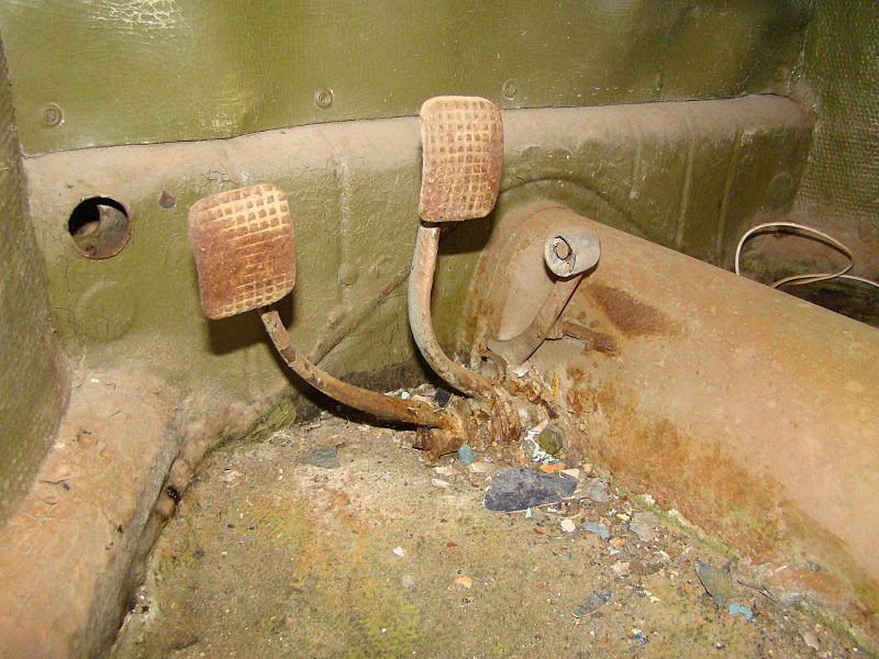

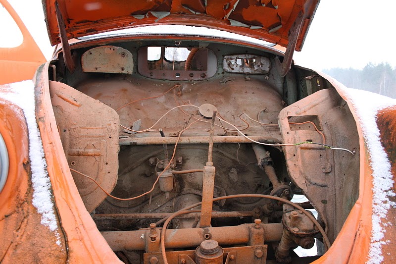

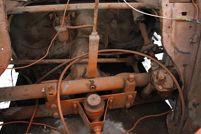

Under the hood the fuel tank is missing but everything else seems to be there including the “ears” that hide the body number under 10 000 layers of paint. At some point the braking system has been converted to hydraulic.

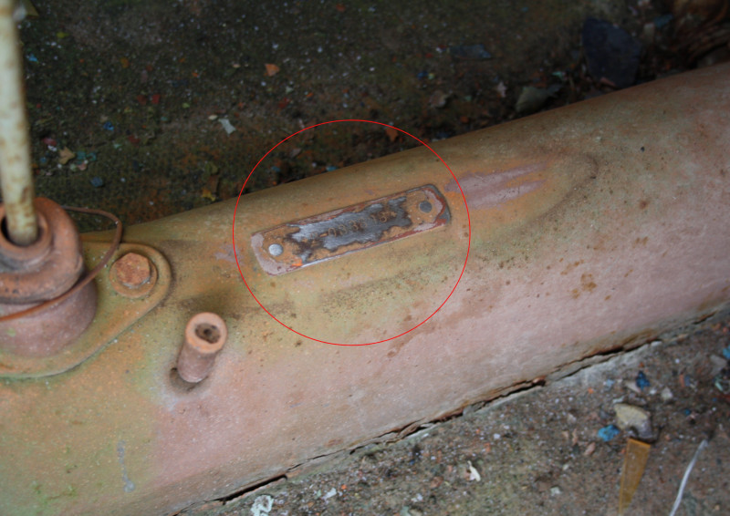

The chassis number reveals its Kübelwagen origin.

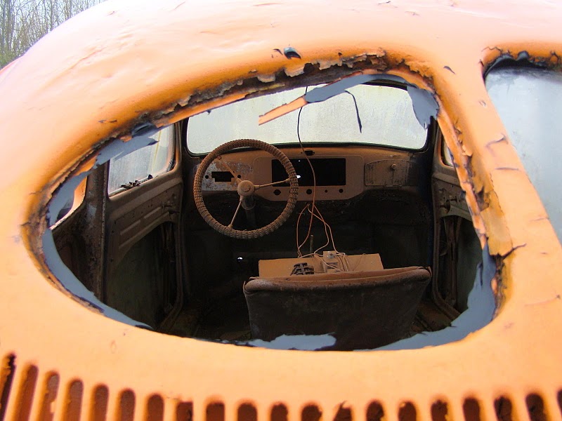

The dash is a mess – modified for some kind of modern car instrument cluster.
The interior is gone, in its place an electric chair.... really no idea what this was supposed to be.

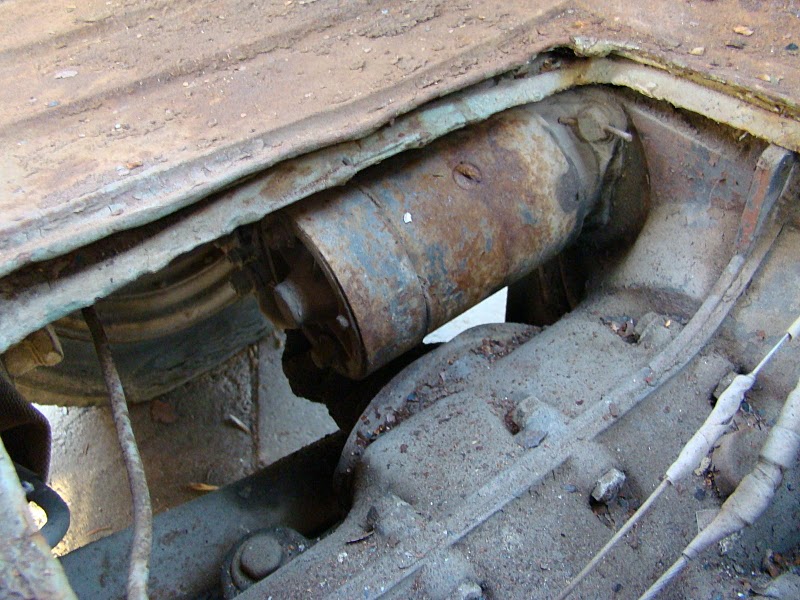

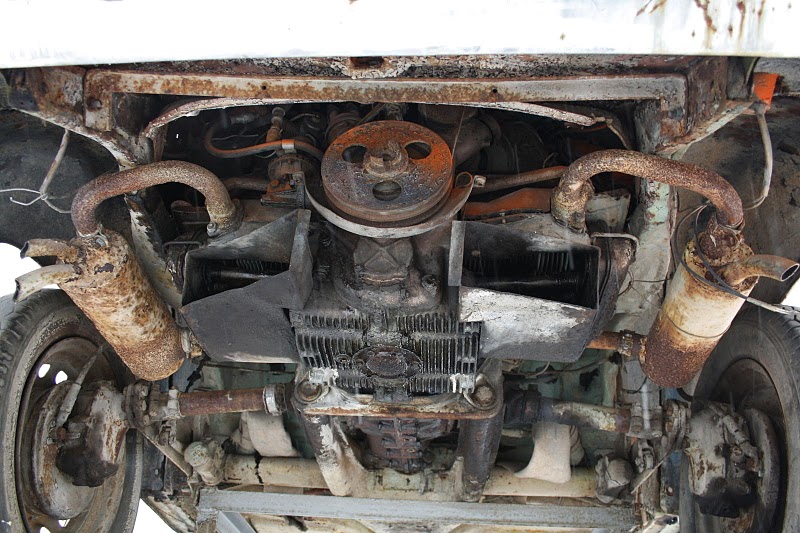

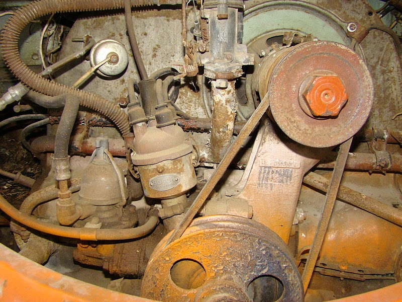

The engine is the real deal, just smothered in strange add-ons and modifications

It obviously sits on a Kubel-chassis...is there any hope for determining the chassis number of the shell? Was it a Type 60 og 82E...I am not sure of the body-number when-revealed can decide that.

The car seems to be made up of wartime VW parts. The chassis is from a 1944 VW Typ 82 Kübelwagen as proven by the prefix 2 in the chassis number. The running gear including the engine and gearbox may be of the same donor, but that still needs to be investigated. The body may be from a Typ 60 (normal beetle) or it may be from a Typ 82E. At this stage the body seems to date from 1943, which is consistent with the build year of wartime beetles found in the Baltic countries.

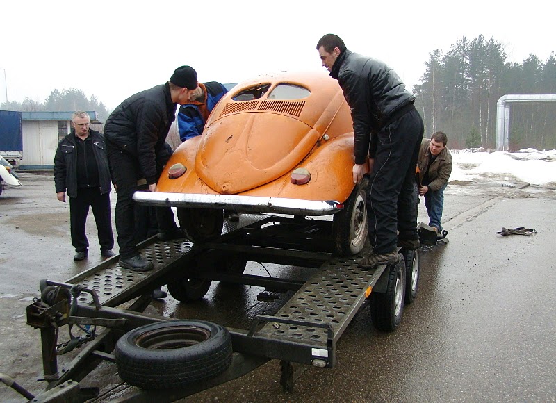

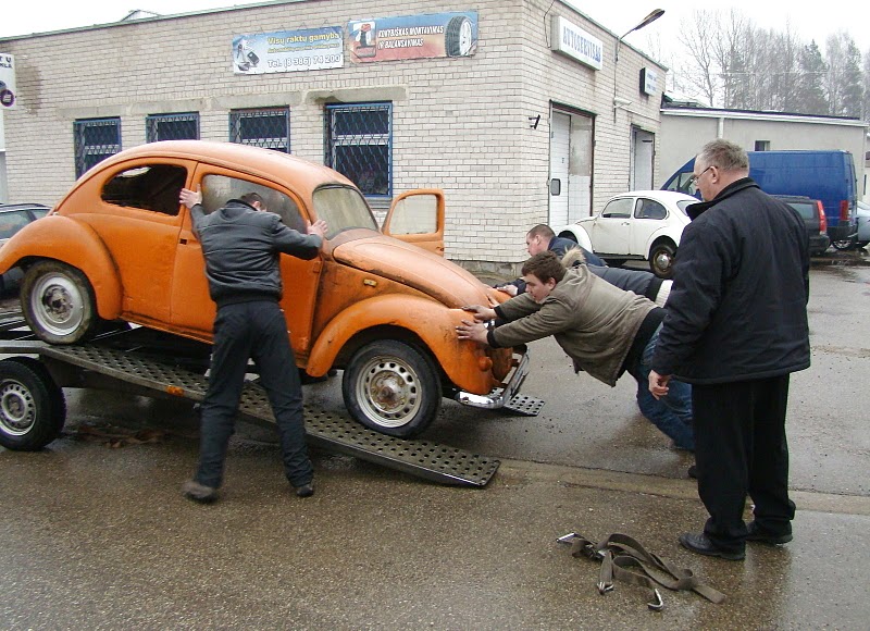

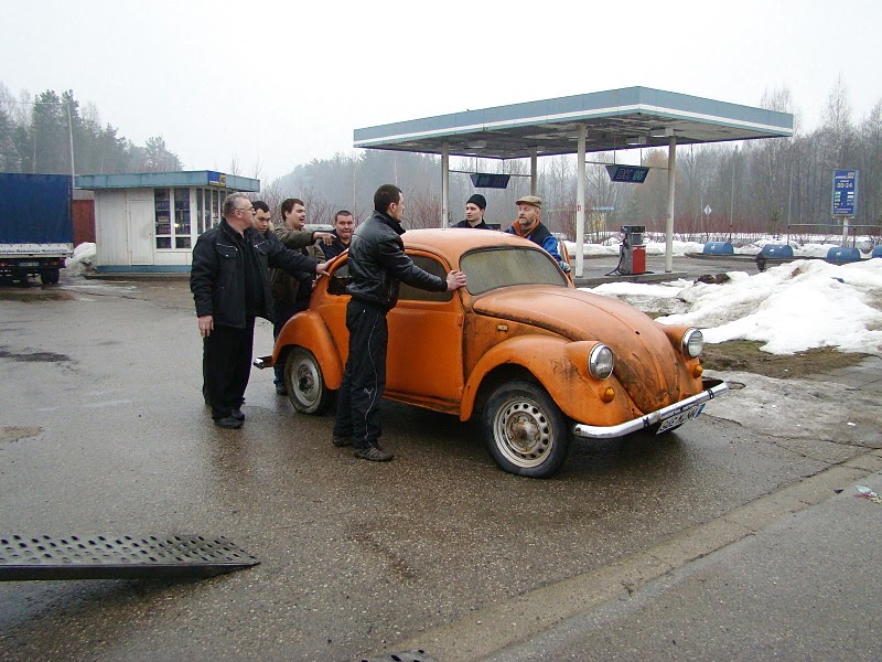

The moment of the exchange. New for old!

The level of tweaking done to cars found in the old communist regimes never ceases to amaze me. That mysterious electric contraption in the seat, just takes the cake as far as weird shit is concerned. Maybe the whole car was an advertizement for Crazy Ivan's Used Cars. You know, "In Mother Country, KDF Drives You!"
Seriously though, it could only be a transformer for a neon sign, or to power the lighting with AC current.

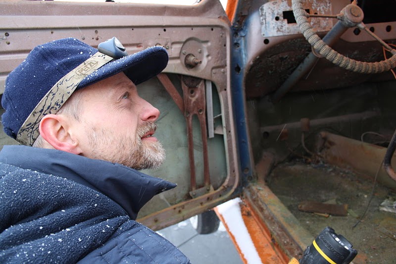

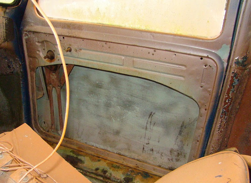

The insides of the doors seem to be well preserved
Could this be a new trend?

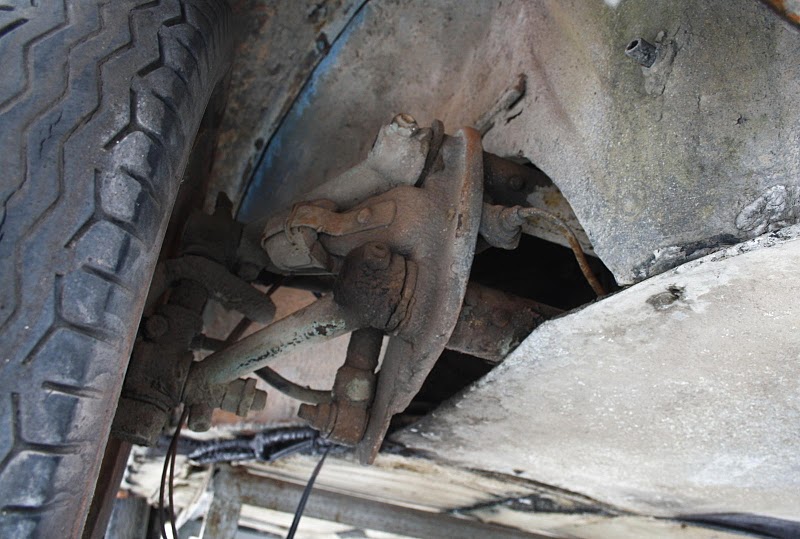

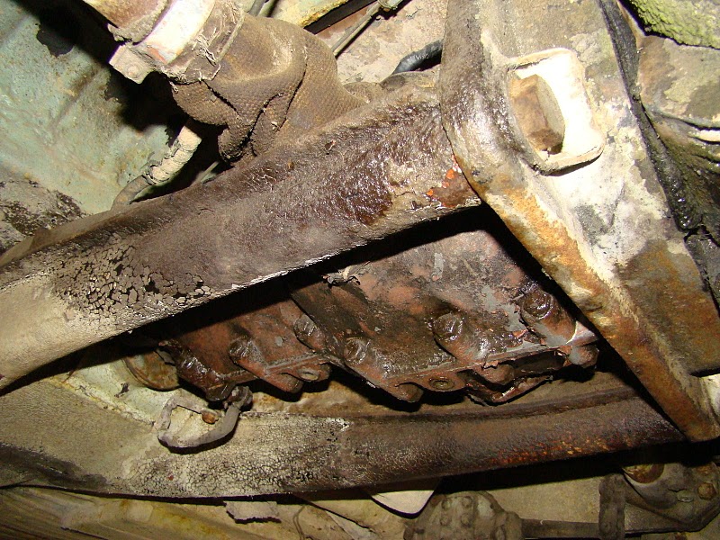

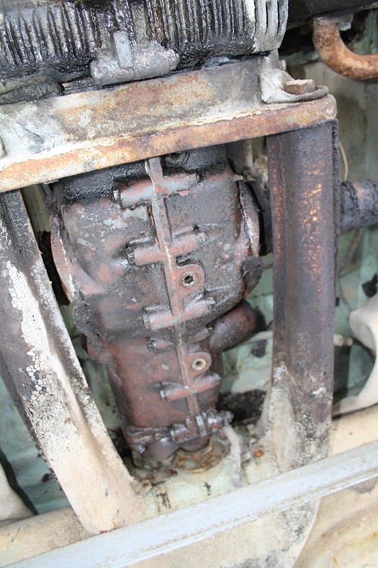

More stuff from underneath. Check out those axle boots!

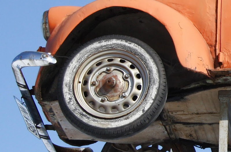

All wheels are from Opel

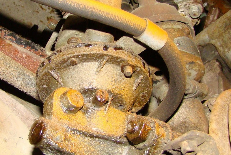

Cog-wheel logos on carburetor and fuel pump

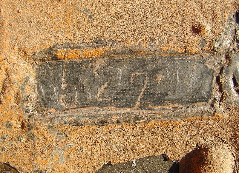

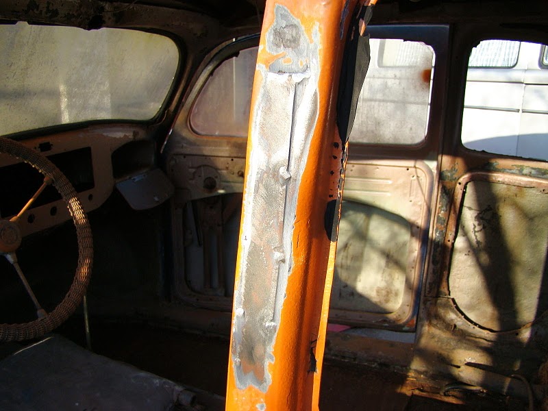

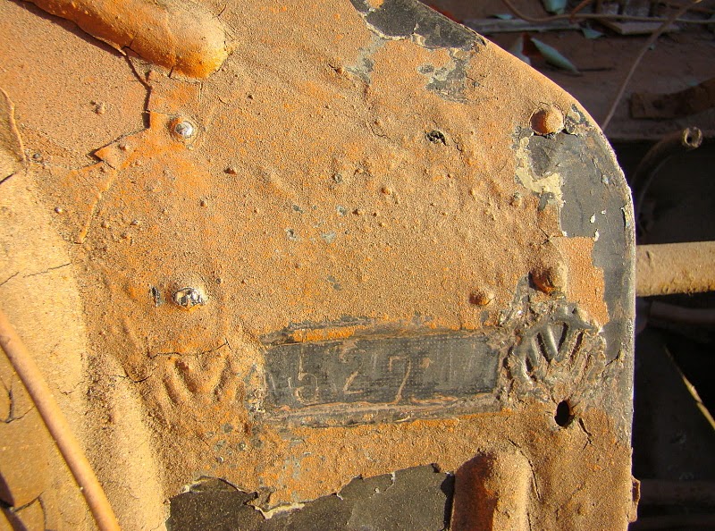

The removal of several layers of paint reveal the body number and the original paint color which seems to be black. Could this indicate a Typ 60?
Welded up semaphore openings!
A curious modification. The rear parcel tray floor has been repaired by welding another piece over the existing one. Rust repair? This also means that parts of another KdF were used to repair this one and keep it on the road.
So, for the numbers......
chassis nymber - 2 - 038606
Engine number - x - 056355 (first digit unreadable)
Body number – 527
