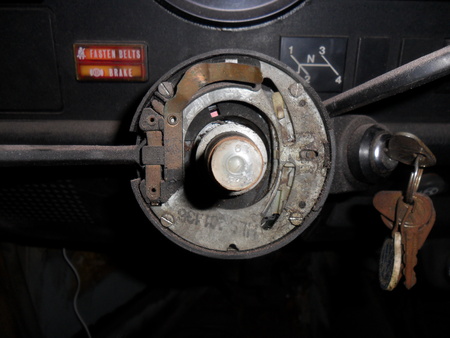

I took off my steering wheel today to investigate the half inch of play from all sides. It would wiggle all over the place and was thinking that it was missing a bushing of some sort. Does anything look out of place in this picture? While I'm in here should I replace anything? Confused

It is called the steerig wheel bearing that is missing or ? What year of bug?
http://www.karmannghia.com/viewDetail.asp?strMasterCat=&idproduct=8217
Look sorta like the picture link.

gt1953 wrote:
What year of bug?
Looks like a 1303 Super 73-79

Hi Alex, theres a bushing that sits between the steering shaft and the bearing in the housing that VW kindly changed from metal to plastic in 72.
They tend to go brittle and fall apart over time then that play starts.
You just have to remove the circlip under the steering wheel and pull out the grey spacer and its under that or what's left of it anyway.
Quick little bug, you got a Porsche motor in that?

Its a 1974 super beetle. Yes, I expected it was a bushing not in place or something. Joel, You said that part of it was still in there? Do you know where I can get a new one?
Does that bushing go in the gap where the shaft is sitting in my picture?

Also missing that funny looking W spring clip that goes on the right side for the turn signals.

That spring clip is part of the self cancelling mechanism for the turn signals.
The little plastic hooks break off and the spring falls out.
I was forgetting yours would be a 74 taper shaft so no circlip.
Just pull that grey plastic spacer thing you can see slipped over the shaft out and then you will be able to see the bearing underneath.
That bushing sits in the gap between the bearing and the shaft and it can be a PITA to get in as it's a tight fit.
Thanks for the tips Joel Smile If I have any other questions ill be back Anxious

If you hunt around under the carpet you will probably find it.
Looks like this (not what the arrows point at, beside it.)
Trouble is if it;s actually fallen out it means one of the plastic hooks has probably broken which is new turn signal switch time.
You can replace them with second hand bits but its a bitch of a job and all it does is the self cancelling part
