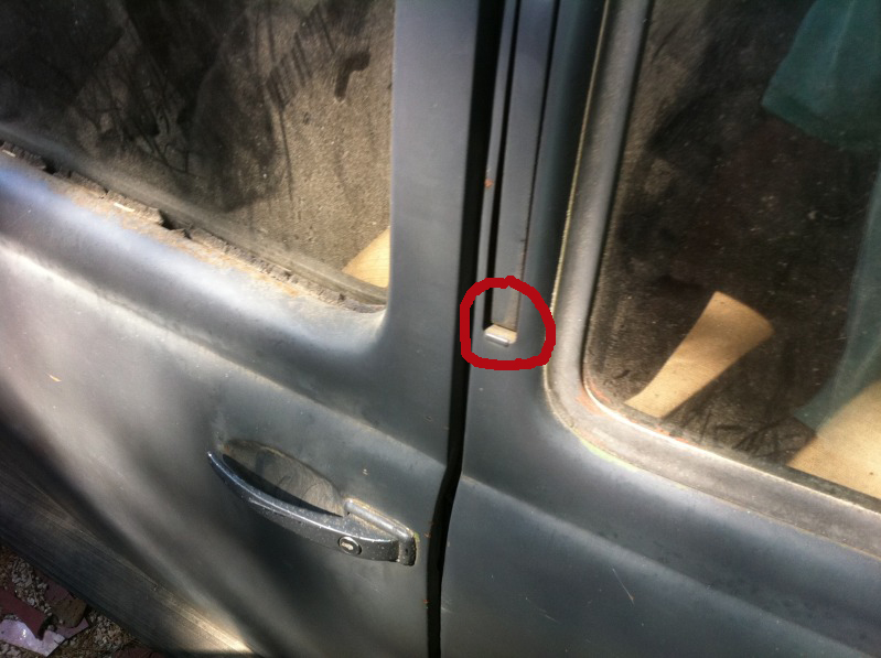

Hello,
I need your help. It's my first post and I am not a specialist (for the moment !) from Beetle. A man propose to me this car. He say it's a War Beetle.
Thank for your advices, sorryfor my poor english |

| not a kdf for sure. looks to be a 50-early 52 standard? still cool! |

. Agree. 4 to 5 years after war. Did you check the number? |

I am not a expert by any means, but I gotta agree with the others so far, looks like a 50-52 to me. I would still take it in a heartbeat if the price was right. polish and roll it as is!

Post the chassis #. With so many replacement parts on the car (from 1950-55 Beetles) it is difficult to establish the actual year of the Beetle.
X2
Agree is a standard split, not kdf otherwise would miss many parts, but the best is to see what is the chassis number. |
| Back to top |
VWKDF Samba Member
Joined: March 17, 2011 Posts: 376 Location: NJ
Posted: Sat Aug 27, 2011 1:51 pm Post subject: |
I don't see any KDF parts on this car.
Early 50's Car in my opinion. |

I have the number !
177 108 |

I have the number, wich is on the body
177 108 |

The number is about 1400 higher than the Jan 51 (Typ 1) number which is 175 714, so the body is from Febr 1951. The chassis may match or it could be changed.

and of course this detail of the semaphore section....

| What is the détail ? |

on kdf and early beetles there is no metal. It´s open. |
