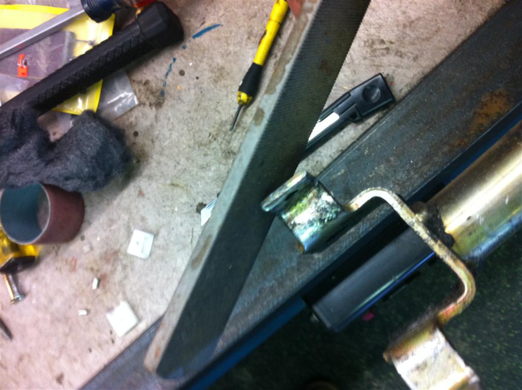

The old ears were completely missing, so other than a wash in brake cleaner and some scrubbing with steel wool, the prep was easy:

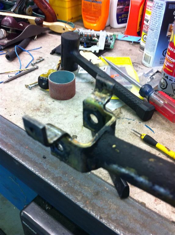

Some relieving of the corners according to the instructions. This is because the milling of the ears was done with a round bit, and the slots have slightly rounded inner corners. Not a big deal, a few passes and it was done.

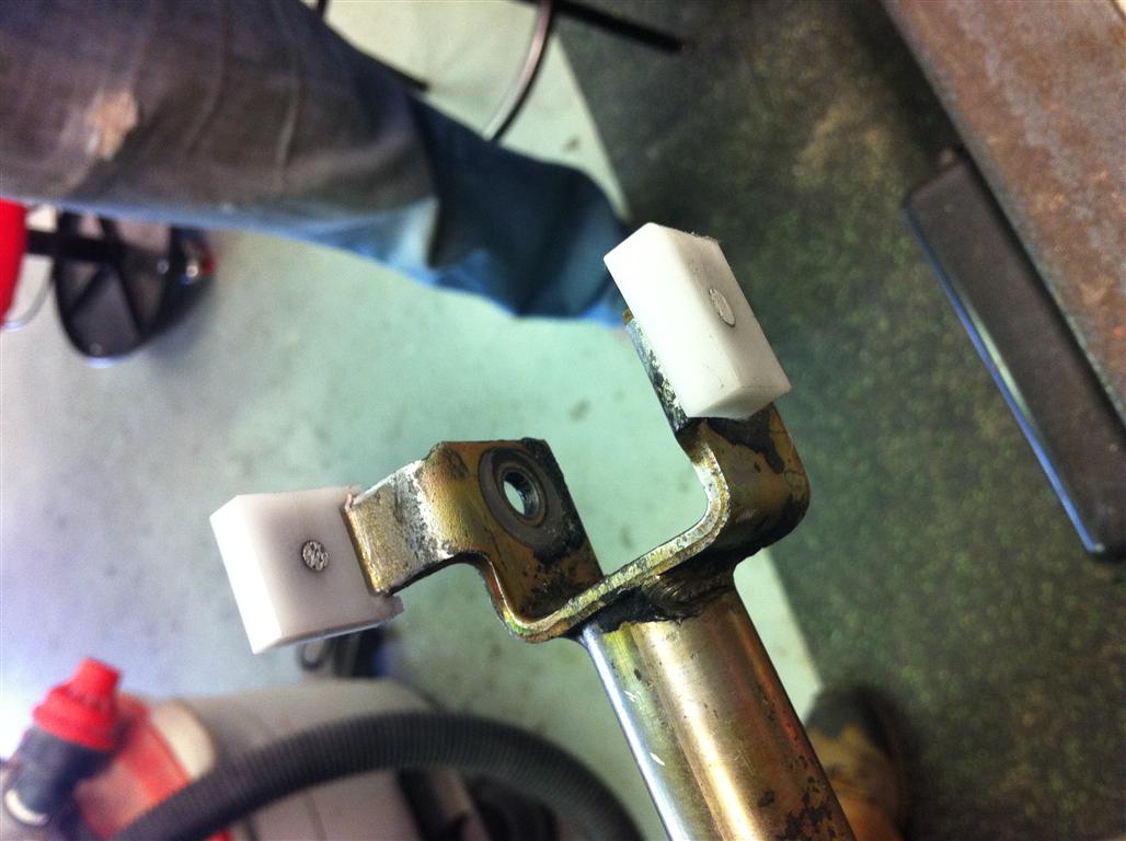

The kit. 45 bucks for about 10 grams of plastic Smile They're extremely well built, though. The little silver things are aluminum pins that mechanically hold the ears in place:
Nice and shiny before the epoxy:
The ears epoxied in place:
A teeny bit of filing on the pins to smooth out the ridges left by the pliers I used, and it's good to go in about 2 hours (the setting time of the epoxy I used):
It feels like a new shifter now. The guides actually hold the shift lever in the correct place. I lubed it with silicone grease, as per the directions.

Can't really tell from your photos, but it looks like those pieces might be identical?
I thought the originals had a different shape.

No, they have the same profile as the stock ones, but aren't translucent, so they look a bit bigger. But they're not Smile You can see the profile well in the pic with my hand in it.
