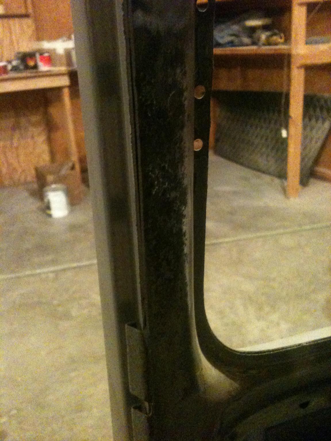

Looking for some help shaving the headliner tabs off the C pillars.. wanting to go with a custom headliner, and body color pillars.. like a standard bug.
The strip above the door, and tabs along the B pillar were easy enough to shave, but the C pillar tabs are proving to be a bit more difficult. I'm thinking about hammering them down, tack welding, and then a skim coat of bondo..
Has anyone done this and how did you do it?
This is where i'm at...
And this is the look i'm going for...

The strip above the door is just spot welded on.. i used a spot weld cutter, putty knife and hammer to remove the strip, and then ground the excess material off. The B pillar tabs were super easy, i just ground the edge down until they fell off... The factory standard bug had a tan plastic edge guard over this.. I plan on using some black door edge guard on mine. Then i used the spot weld cutter again on the assist strap bracket, came off easy. The C pillar tabs are going to be a lot more work.. if you just cut them off it leaves a hole behind them. I considered cutting that area out and welding in a strip of sheet metal.. but there is foam insulation inside the pillar so thats gonna be a mess.
This pic shows some of the tabs ground off.

I ended up hammering the tabs down, welding them up and grinding the welds down.. Then I taped a hard edge and layed down a skim coat of bondo. I'm gonna put a bead of seam sealer in the corner before paint.
