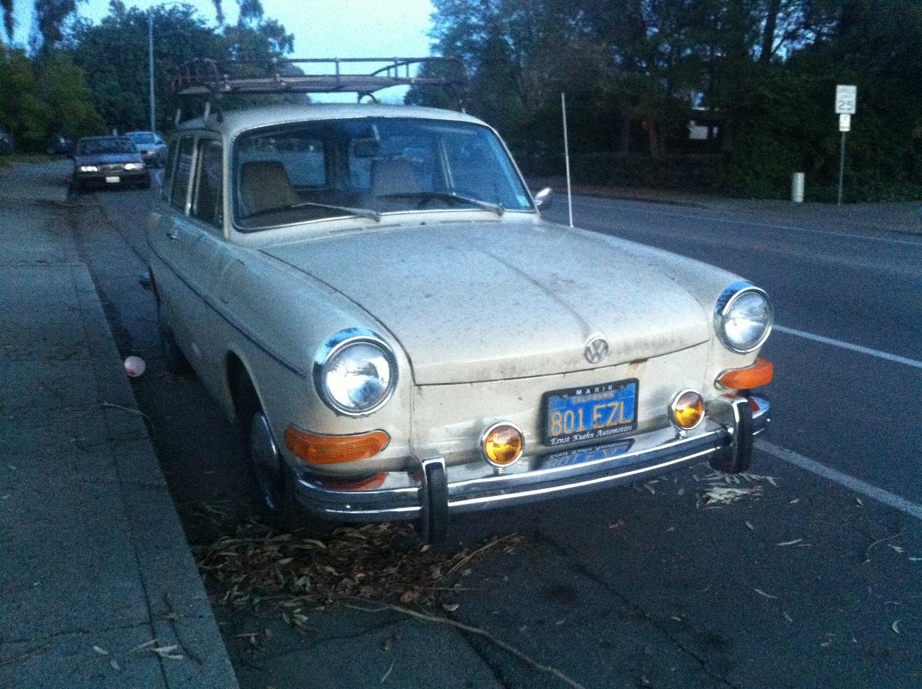

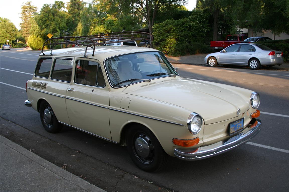

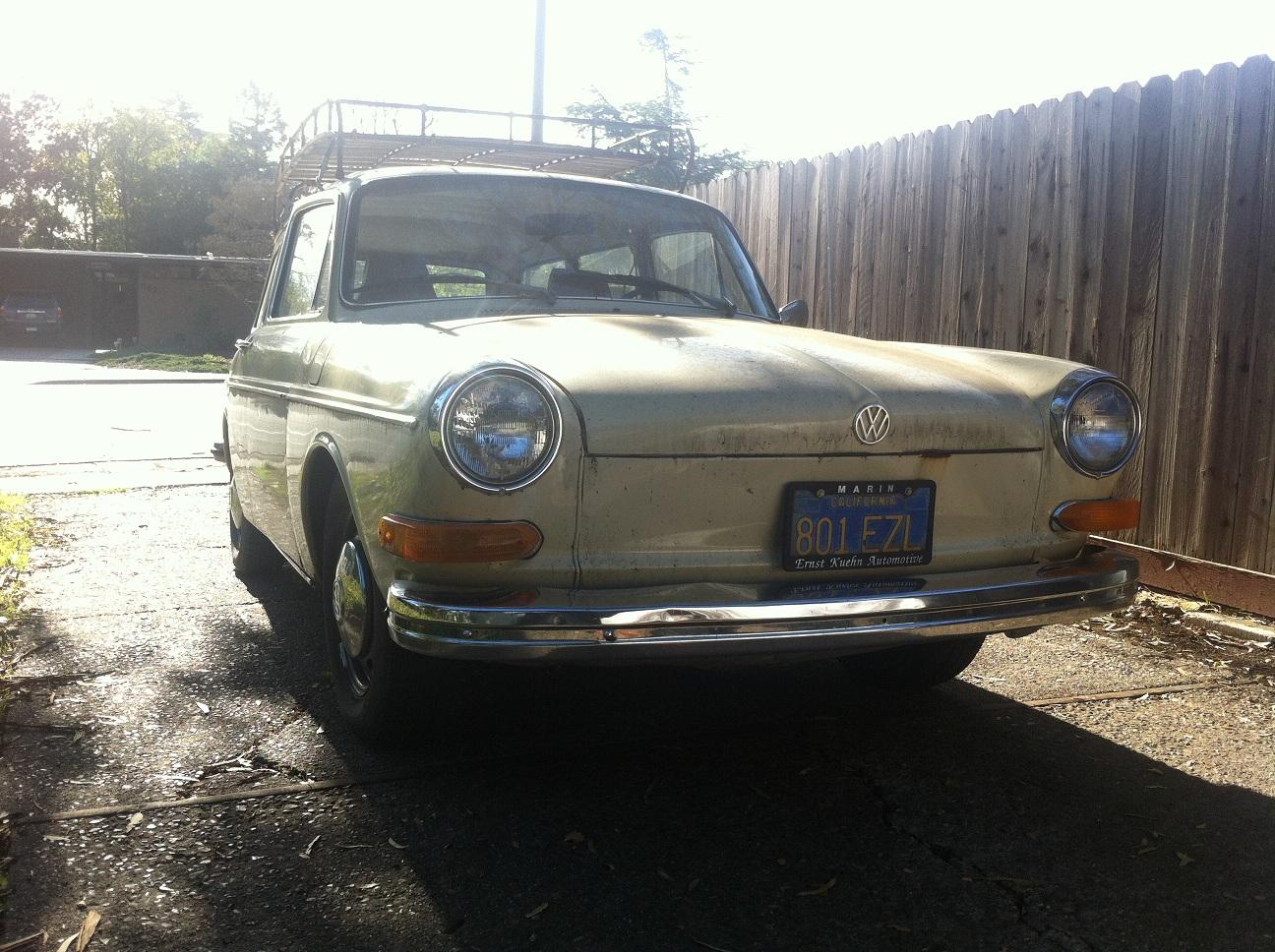

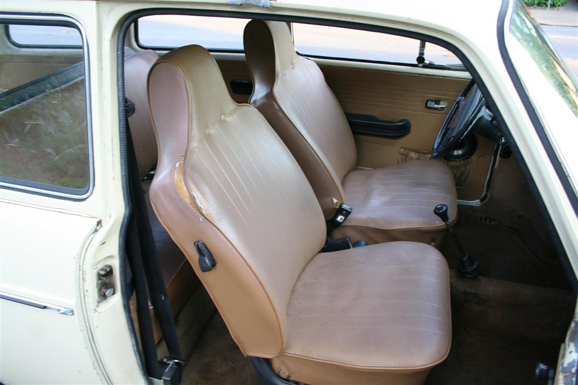

Thought I'd post up the 72 I've been working on lately. Sold off the 58 single cab because I needed a smooth vehicle to travel in. Don't get me wrong, I like the old split window, but it is more of a piece of farm equipment than an actual vehicle. With that in mind, I picked up this nice 72 from Berkeley Ca. So far it has been the most original, least molested and finest running of any VW I've ever purchased (as purchased). Even the clock works!
Does anything appear to be missing or wrong in the engine compartment?
(I know about the air filter to body snorkel, and the missing start injector)

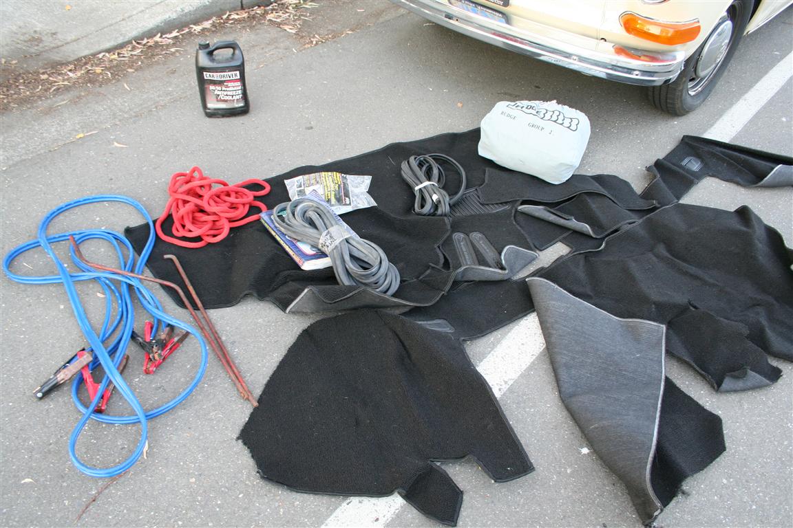

Best yet, look at all the stuff that came with it. A few extra rubbers, an interior kit I have no intention of installing, a muir manual, and even some bonus coolant. Shocked (The PO had no idea about cars. He told me on the phone that it was carbureted and didn't know how to work the heater or vent controls.)

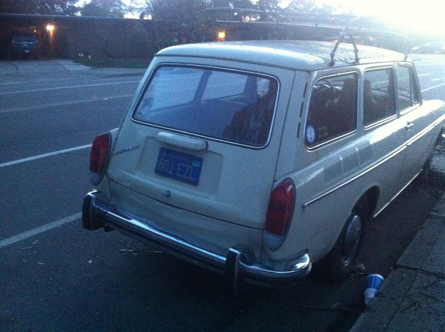

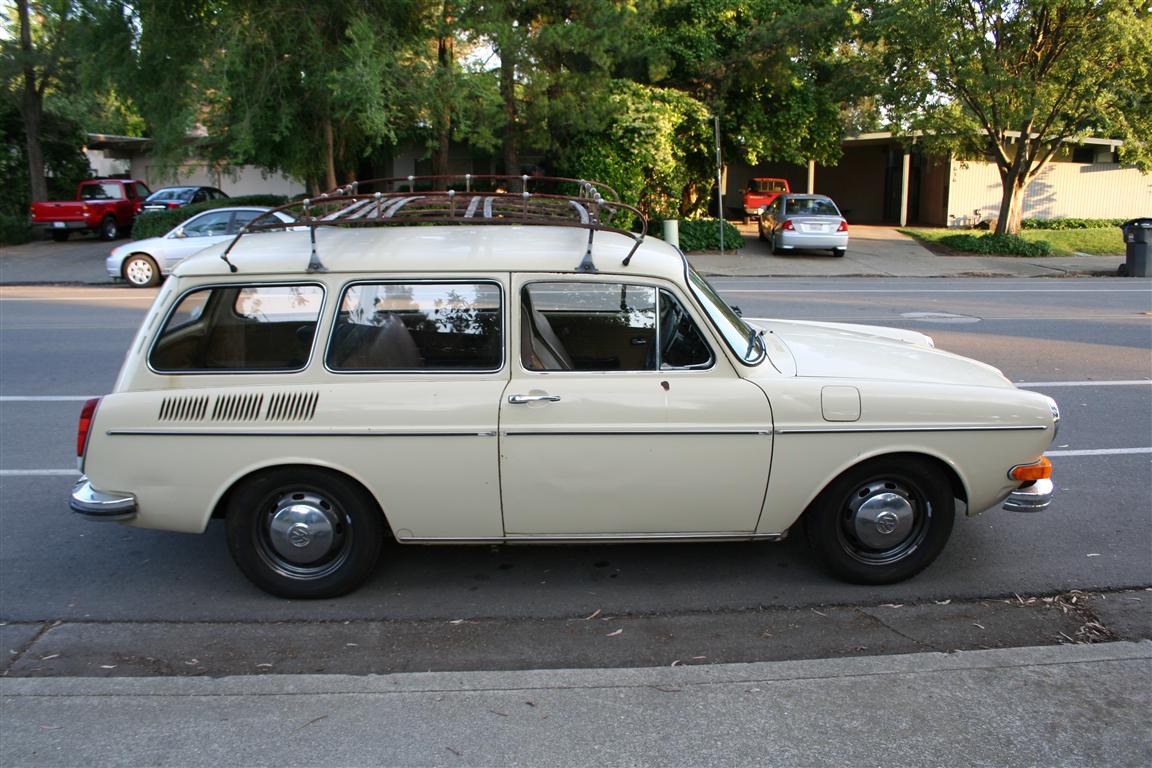

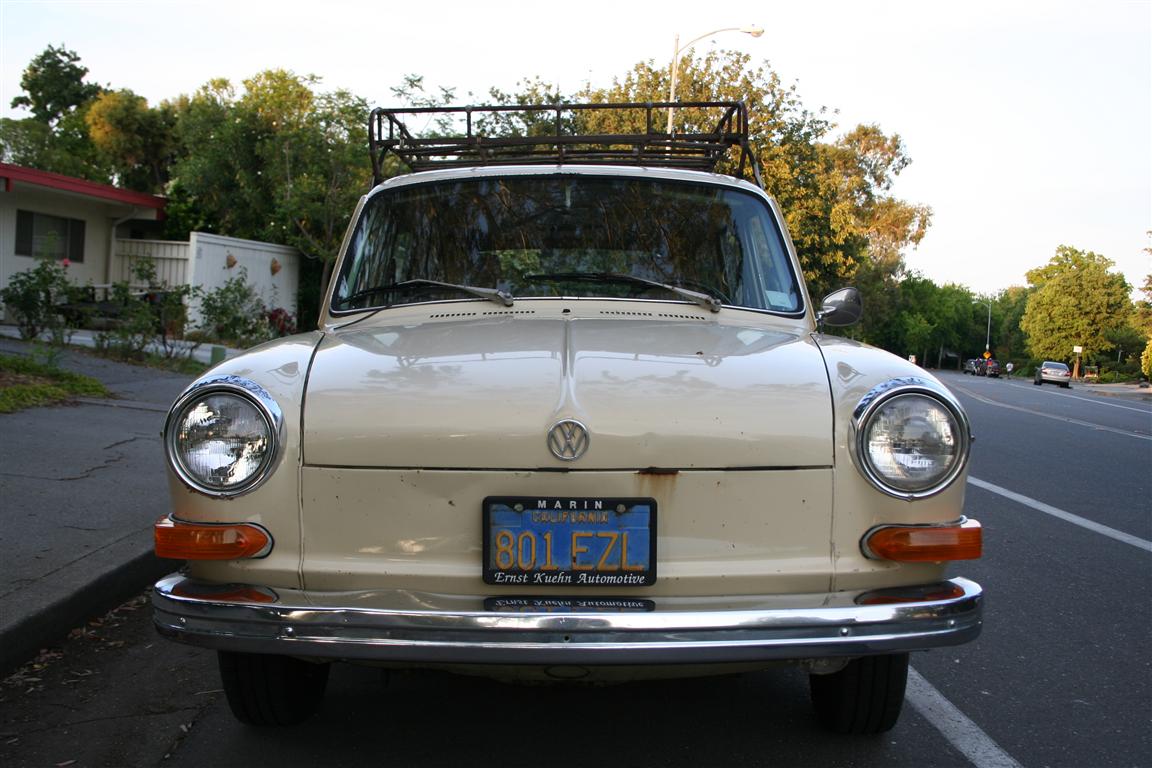

Finally, does anybody know what this rack is off of?
The four parts that connect the rack to the roof are hose clamped on and aren't part of the rack. But the four posts with rubber feet are. What the heck is this rack from??
Also, how would I know if this car came originally with overriders?
Check out the aftermarket side stripping that a PO put on. Instead of a chrome line, a black line. It almost doesn't look that bad. I will replace it eventually.
Does it look lowered a little? I can't tell.

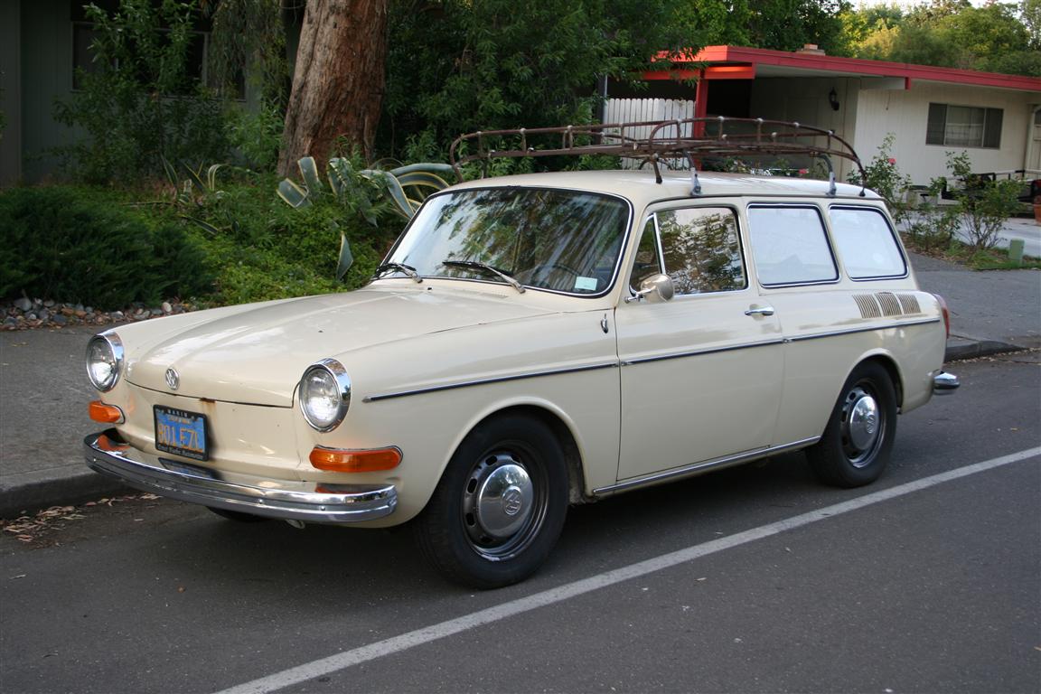

Small update, finally got the foglights and some bumper overriders installed.
Before:
After:

Looks real good. I just picked up a '71 fastback and want to add the same fogs & bumpers.
