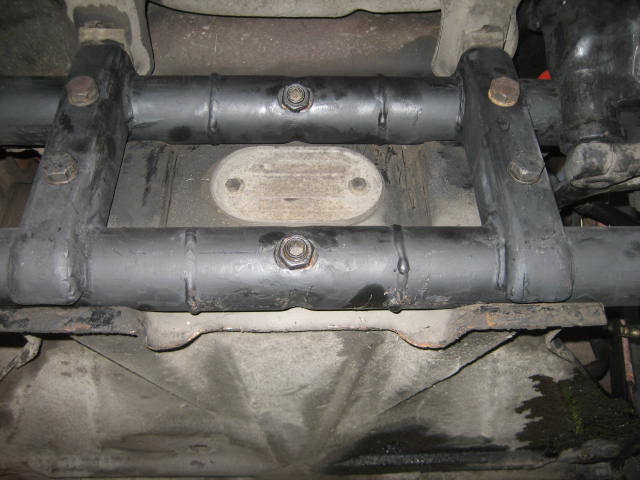

An unmodified bare ball joint beam:

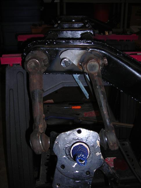

A Glorious Modified Ball Joint Beam: Thing spindles and arms, hook and rod stops, rod up front, adjusters and reinforced towers:
A spindle and ball joints up close:
note that one ball joint points up and one points down. Later on, we will explain why this is a problem

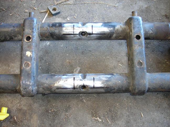

A front end with a 1/4 inch cut and turn:
the bolt on the front was at a 45 degree down angle. now it's a few degrees below horizontal. the metal fabricator:
  • scribed a line on the tube
  • cut the center of the tube out
  • repositioned it with the line in the cut out part 1/4" above where it was
  • welded it back together
getting about 2" of lift for his efforts. you can cut and turn 3/8". good luck getting the spindles on.

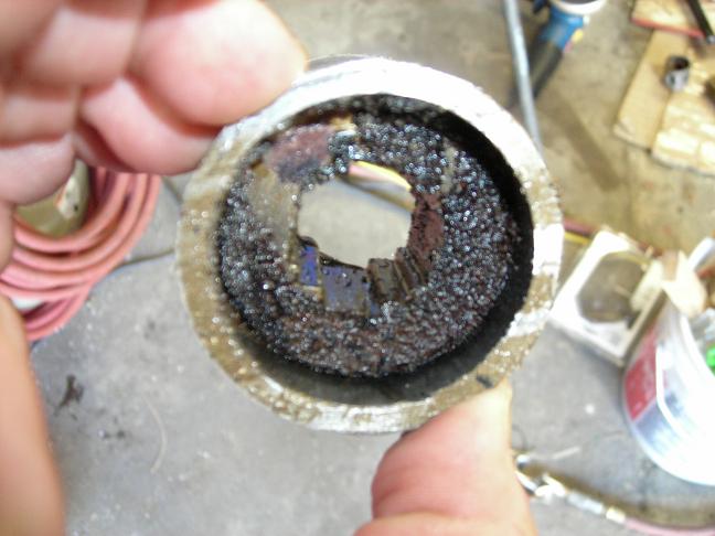

Oh, yeah. BTDT. A robust bump will disassemble a ball joint in flight.
How to prevent this? limit the range of motion of the trailing arms. put a big old 3/4" rod through the beam, make some plates to contact the rod just before you stress the ball joint, and weld it all up.

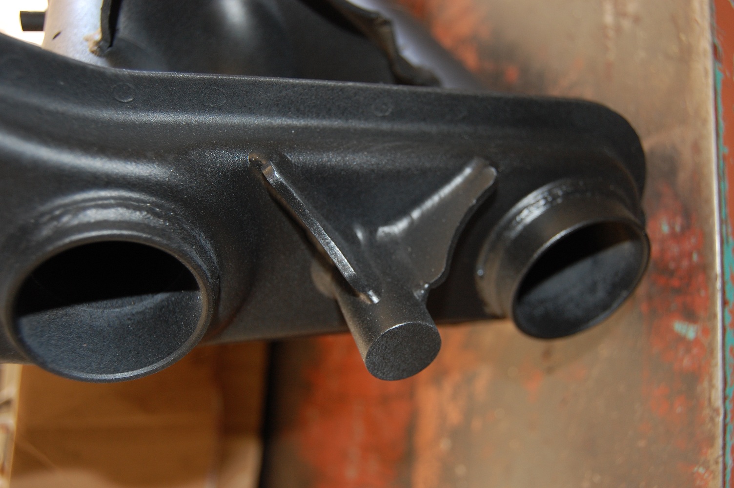

an enhancement to beef up the rod:
you have to rotate this image right to see the hook and rod in action:
NOTE! some fabricators put the rod at the front of the beam. some center the rod. the ones who put the rod at the front of the beam don't complain about the hooks fouling each other. there is a lesson in there somewhere.
