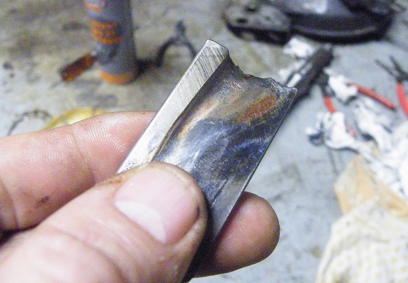

Here’s what I have found, only on the left side :
What can cause this ? obviously a lubrification problem ? the poor man posi too tight, for road driving ? What can be done to improve oiling the super diff? bigger holes, another holes? where ?
Thanks for your help !

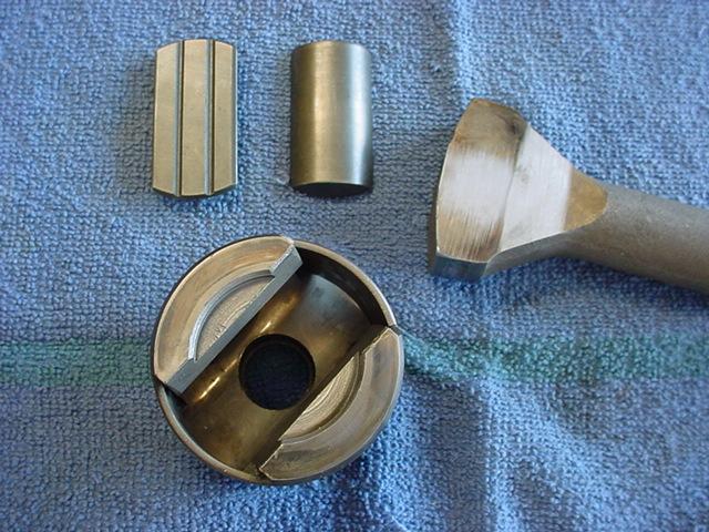

Apparently what I see in your last pic of the axle spade are the sharp corners which would gall up the fulcrum plates.
Best solution to reduce wear on the fulcrum plates is to get your axle spades radius (remove the sharp edges) and polish the ends.
I've done that to my set of SAW axles and I'm also running the GB Poor Mans Posi kit.

Speaking of fulcrum plates, I'm running grooved fulcrum plates that looks like what's pictured below (not my picture):
I bought my set from Gene Berg a long time ago. _________________ Jim Kikuchi

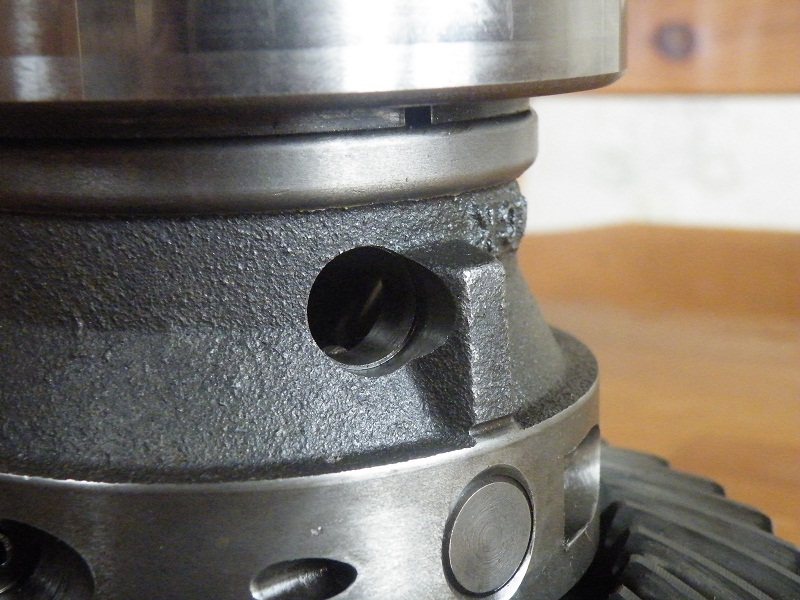

Here are some pictures of the oiling holes enlarged:
"scoop" effect "improved" and bigger hole :
The same from the inside :
The 4 small near the ring, and from the inside. at left, the stock hole, at right modified, drilled with an angle. so the hole is now in an oval shape (11x9mm) is that enough ? :
_________________ 2276cc daily draw through. |
