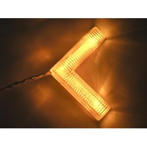

The ford f-150 Raptor has a great LED side marker lamp which might work well and surfaced mounted.

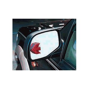

I think these are Mercedes mirror markers. Saw these in Germany a few years ago at Claer's shop. He's the guy doing the Porsche conversions.

Jedi
Joined: October 23, 2007
Posts: 734
Location: Cool California
Jedi is offline
PostPosted: Sat Jan 28, 2012 6:06 pm    Post subject: Reply with quote
Applause Applause Yeah that is like I was thinking right there. Cool That is one sweet looking signal Applause Applause Now the race is on to see who can do it first here in the USA. I am looking forward to seeing peoples ideas VW Logo
