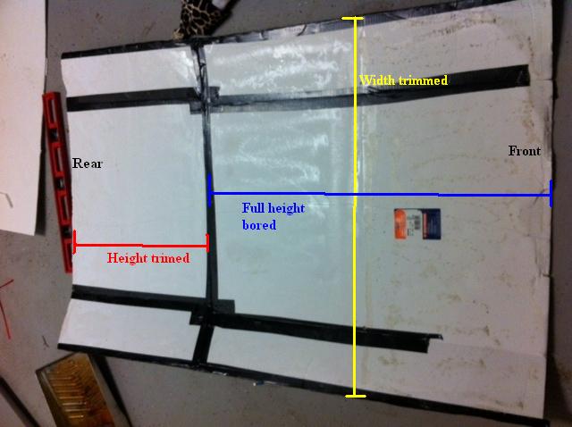

Beartoe_jr wrote:
I recovered the headliner and took some pics of it before i recovered it. 2 science project boards made out of foam, duct tape, headliner spray, and fabric. I think its pretty easy to see what i did. Feel free to ask if something isn't clear.
1. Trim the full length board's width so there is just enough board on the sides to hang on the roof lips...
2. Cut down the hieght of the second board and trim the width like you did for the first one.
3. Duct tape the seems to include the folding portions already on the board to renforce them. Only tape the side that faces the the floor you still want the joints to be able to fold for install.(They will eventually break apart but the duct tape allows it to hold the form)
4. Install the board uncovered by sliding one end into the passenger side roof lip an pushing up on the other. If it is trimmed correctly you'll have just enough room to clear the driver side then when you center it the driver side lip will catch.
5. Use a heat gun to help form to the roof. (optional)
6. remove the board and cover leaving about a half inch of fabric hanging over on all sides. (the extra fabric helps to hide any imperfections from trimming the width.
7. Reinstall and use a putty knife to slide the rest of the fabric in.
trimmed and taped
covered and installed
