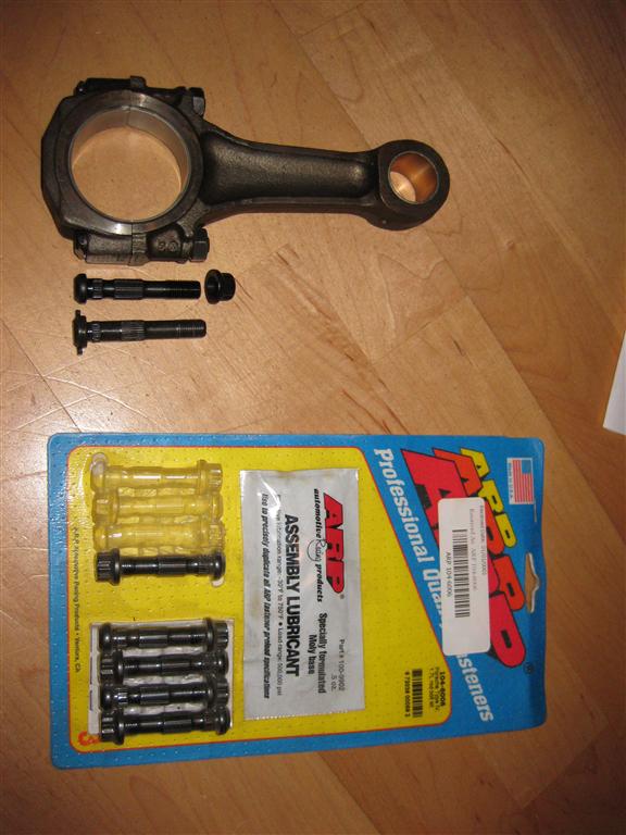

If you take a good picture of the rod bolt in question I can likely tell you if it is torque-to yield or not.

NOT torque to yield
but I see you went the ARP$$$ route, fine with me Wink

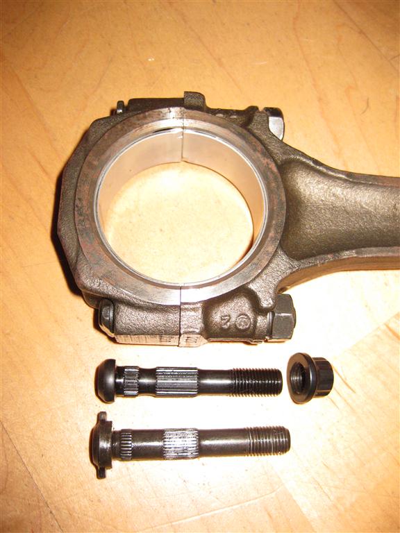

Are you telling due to the hourglass shape Modok?

The stretch bolts usually have either a reduced shank size and/or the threads extend WAY longer down the bolt than needed, this allows it to stretch evenly
the old bolt, which is the lower one in the pic, does not look like that at all
the arp bolt does have some of that going on, probably just to reduce stress points and just plain nice design.

PostPosted: Thu Jun 14, 2012 6:29 am    Post subject: Reply with quote
these are the bolts that are too short. If installed they will only allow the nut to thread on half way. Like I said in the first post I can't find the part number for the longer bolts(arp) these are for the 1.7/1.8 rods. The cost of the arp bolts (if I can find them) and the cost of re-sizing the big end is close to AA h beams with arp bolts.......I may go with the china stuff.
