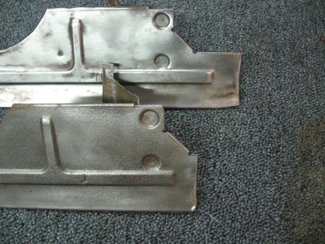

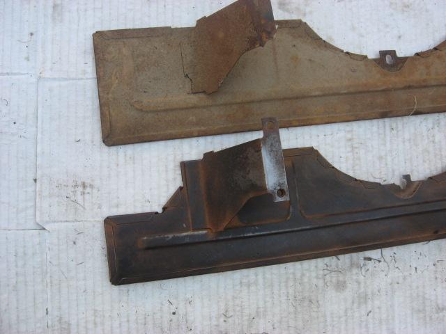

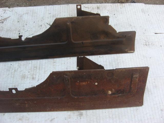

when i first looked at these
i thought to myself that some dumb ass PO
cut the end off one of the shield
but while i was clening them i noticed the short shield
is not hacked and is factory made to have a shorter end
the question is
have any of you veterans noticed this before
and what year modal could require the shorter end
at first i thought it might be shorter for the a/c compressor
but the shield does not go that far to the left in the first place
the only other reason i could come up with is
the preheat tube on 75-early 76
or the heater box inlet on 79 ca (driver side)
ive had these for a while trying to figure out and confirm
why 1 of them is shorter on one side
ant thoughts would be great.............

Both of my 79CA has that same thing.

Here's the original shield from my 1979, if that helps you to figure out which is which.

so then its confirmed....
the short heat shield is specific for a 79 ca
thanks guys

Probably not just a CA model though. Mine is a Federal 79, and has the short shield.

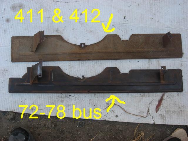

i thought it would be pretty cool to add
the type-4 heatshield to this thread
thats 411 -412 type-4
as you can see its the exact same size only without the notch on the end
i have not checked to see if it will fit in a bus, since it does not have the notch
i guess this will be the unofficial thread for type 4 heatshields
are there any others out there that are almost but not quite the same
as the 72-78 shield
