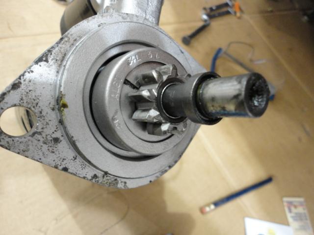

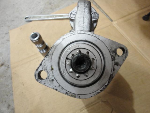

PostPosted: Mon Jul 16, 2012 5:48 pm    Post subject: starter details. Is the bendix correct for 6 volt flywheel Reply with quote
Thanks to those that have given me info on my starter compatibility question. When I got home I took my starter out and counted my ring gear teeth. It has 109 teeth. I have been told that the 6 and 12 volt starters have the same number of teeth so is mine a 6 or 12 volt bendix? The electrics are 12 volt.
My starter is an AL/EEF 0.5/6L4
Thanks Ron Question
