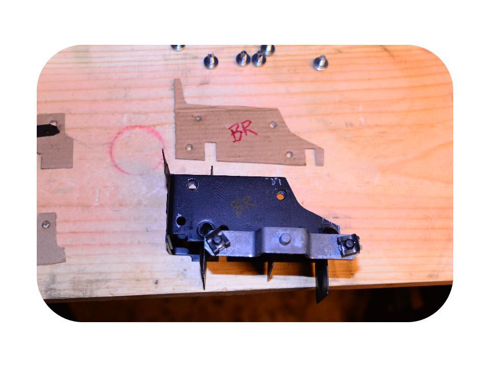

In that last picture (the one with the tape measure), you can see the linkage bracket laying next to it. Right near each end, the bracket has an existing bend at nearly 90 degrees. In my case, I needed it just a bit longer. In order to accomplish this, I "flattened" out the 90 degree bend; effectively lengthening the piece. Once it was the correct length, I had to re-bend slightly to make the piece flat again. Make sense?

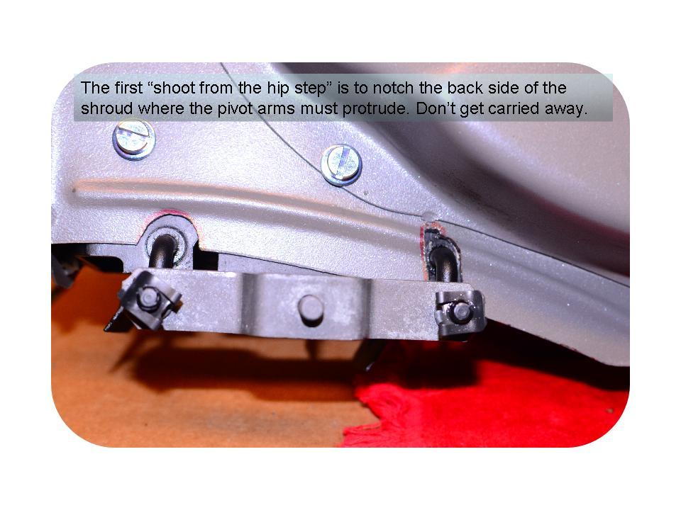

One is on a T-4 you must beware that the #1 spark plug hole is very close to the linkage and you have to make sure the linkage does not hit the plug wire or insulator.
Two is the rod that goes to the thermostat has to be custom made due to the additional length needed. Also on a T-4 you will be using a T-1 thermostat holder. For a T-4 I recommend using the later T-1 thermostat that opens at 90 c instead of the 80c . T-4 runs cooler so you need to let the engine warm up longer. T-4 or T-1 the 36 hp fanhousing really adds extra spare to the engine compartment and allows for easy adjustment of duel carbs.
