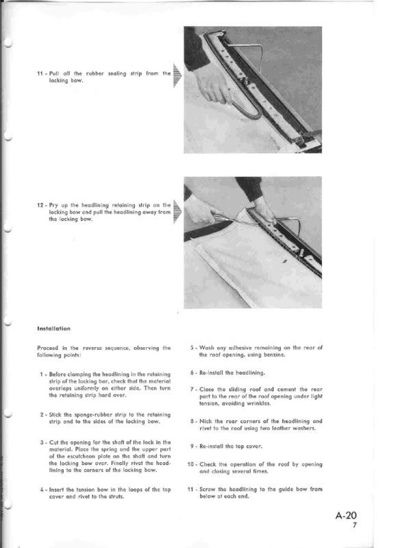

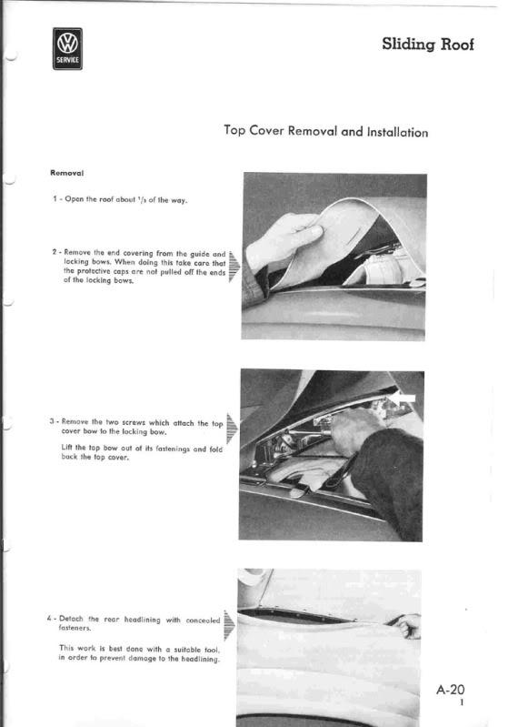

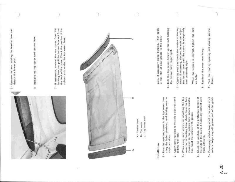

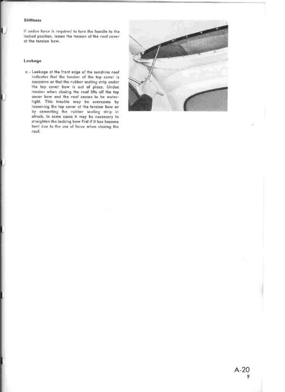

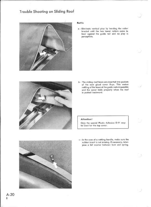

found these, hadn't seen them on Samba, so I thought they should be here
Enjoy. SD
