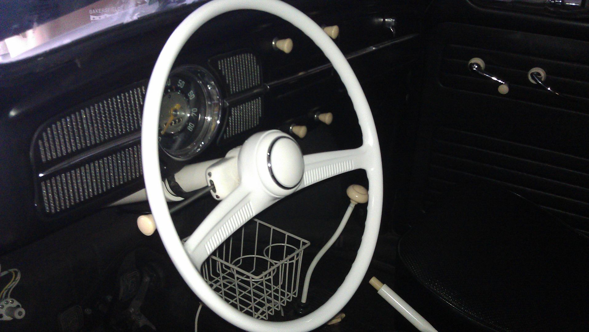

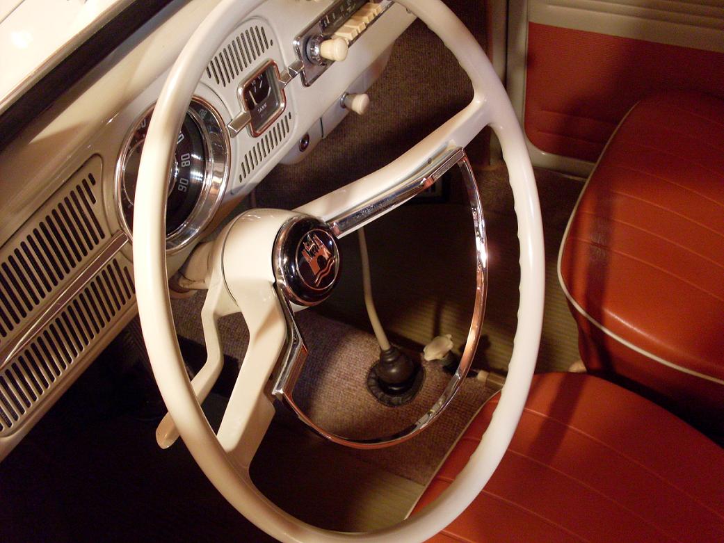

We know that plasti dip works on tools, but I wonder what repeated hnandling over a long period of time will do to the finish. A gummy feeling wheel won't feel good to hold. I refinished my '59 wheel at home with some 30 minute epoxy mixed with micro balloons for thickening and a can of filler primer and a can of appliance white epoxy. Probably spent about 20 bucks total. Other than sore finger from sanding, it wasn't too difficult to do. It now looks brand new and feels smooth to the touch.

Wow evlwevl, that turned out amazing, good job!

Very very nice evlwevl. I used the POR 15. Sanding the POR 15 was a killer. My wheel was cracked, but not as bad as yours and you had all the intricate grooves to work out.

Your wheel looks very nice. The original poster should see these examples and give restoration a try rather than something he might have to scrape off later when he's not happy with it. I decided to restore this wheel because the cracks which were worse in the back of the wheel, not pictured, were in areas that were not too detailed. I also have a bat wheel at home that needs a restoration and in much worse shape than my '59 wheel. I'm hesitating that work because that wheel is very detailed front and back and it will be much more challenging to recreate all those small indents than lets say an early 60s wheel.

Yeah, the earlier wheels are much harder to do. I've heard of guys taking many many hours to do one and do it right. That's why a restored one brings good money.
BTW Did you also do the turn signal. Looks good.
