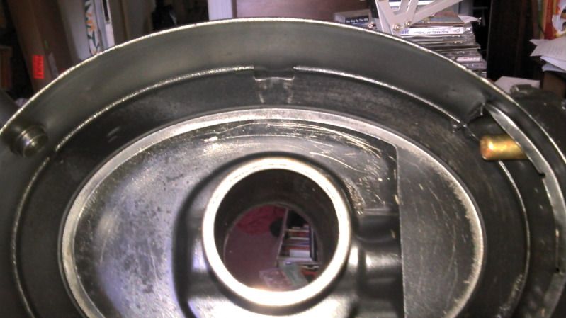

Anybody know the proper oil fill level for this air cleaner?
Is it the Lowe level where there is an overhanging flap of metal or that seam line above the slope and just below the intake holes?

The lower part, just above the bottom, looks like this
Forgive my ignorance, but I don't see how looking at owner's manual pages that say "fill to the mark" is helpfull. Been there done that. My point is, where is the friggin "mark".

onetuza wrote:
I'm not sure of the year. I bought it to replace also incorrect single snorkel cleaner on my 71 engine.
Not sure what a "rim lip" is.
The actual '71 oil bath is the one with the OYO thermostat, now unavailable except by luck or used.
Looks like yours is a 68-70 with the cable actuated flaps.
Here's a pic from my '71 oil bath which I think will have the same base dimensions as yours.
You see that dopey looking arrow thing at the top of the pic? I always filled it to the bottom of the arrow and never had a problem.

first off, the single snout cleaner is correct for the '71 model year, that is a one year part with a thermostat controlled pre-heat flap (the cleaner will have a big spring thingy on the side) what you have pictured looks to be a double snout cleaner (the picture is awful and blocks all the parts important to identifying its year) from a 67 or 68. I digress however, there should be a lip just above the actual bottom of the air cleaner, you fill up to this lip. on later air cleaners there is an arrow stamped in the metal (an actual indent) to show the fill mark. earlier ones had a red line. sometimes this arrow is pretty hard to notice due to age and or grime.
hope this helps
