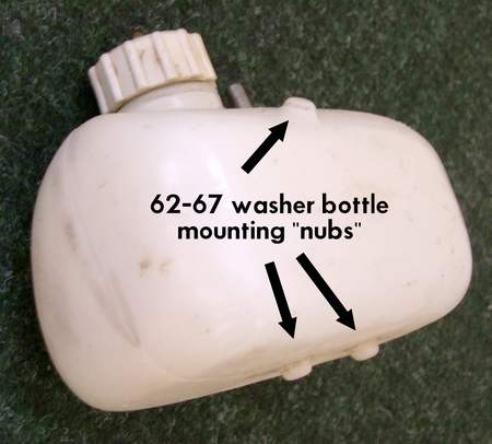

What holds the washer bottle in place? I'd like to take it out and clean it, but I don't want to break anything.

It is just a press in fit, should pop right out with a little persuasion.

there are 3 'nubs' part of the plastic of the tank that click into matching holes in the body. Sometimes you can pop them out, other times they are really locked in there and it can help to crawl underneath and press up on the two you can see from below... and maybe have someone help it out from above.
an old thread about this:
http://www.thesamba.com/vw/forum/viewtopic.php?t=320644&

Got it. Thanks guys. Now I need to fill it and need to see if the hose is clear.

Be REALLY careful trying to get it out! If you pull or pry the little nubs will crack and you then hav a leaky bottle.
It's best to push the nubs from the bottom.
