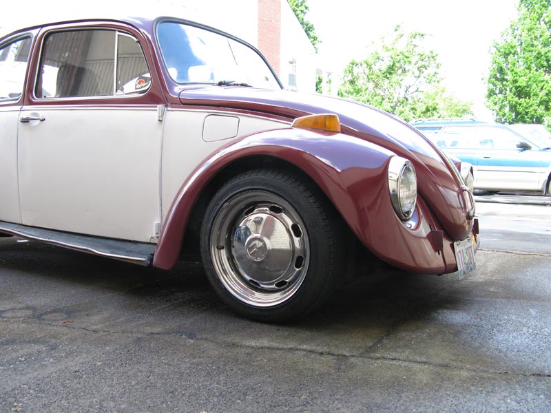

Hi folks,
I have a 1970 Standard beetle with Drop Spindles. The front tires rub like you would not believe. There is a groove in each tire there they rubbed on the front fenders.
Anyways they are currently the same size as the tires on the back. P195s, cant remember the rest.
The shocks are good as there is a good amount of bounce back.
I need to get two new front tires and need to know what size to get. Then I sit in the car you can see the fender touching the tire.
Here is the only photo of the car that I have at the moment....

Here is a photo of how it sits not with no one in it:

If his '72 is a super, it's got McPherson struts in the front so it wouldn't use drop spindles for lowering and might not make such a good comparison. Even if it is lowered the same amount, his wheels wouldn't be pushed out the extra 1/2" because of the spindles. You could swap one of his wheels and tires onto the front of yours and know for sure the tires will fit... if his wheels are the same width and have the same offset as yours.
Your 185/60's have a 111mm sidewall and his 185/55's are about 102 so you wouldn't be gaining much in height and the width is the same. Personally I think a 100mm sidewall might work but you're going to have to go narrower...like 165 or 175 maybe, to get the sidewall to curve in and clear the fender lip. Even pbullblue's 175's aren't a good comparison because his wheels are only 4.5" wide and the have a different offset. You're wheels are wider and have more positive offset.
I've put alot of thought into this since I bought my front tires without thinking about it enough... can ya tell? Confused
Another option is stiffer shocks to cut down on some of the travel.... How are your fillings? Very Happy
edit: Ya' know, the more I look at your pics, I think you could just go narrower and keep pretty much the same height. You've got the clearance over the tire, it's the width that's killin ya.
