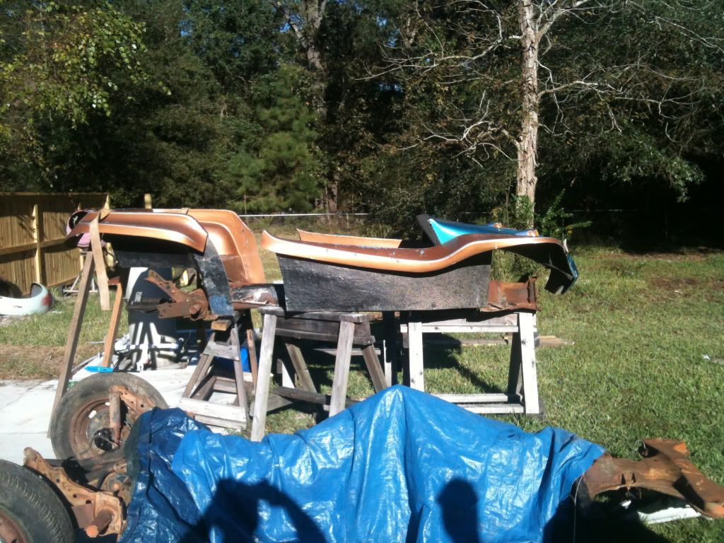

Lots of folks use a board covered with Aluminum foil and lay up on that in place on the buggy. I scabbed pieces of fiberglass in on my stretch. Not a bad idea to bolt the body to your pan when you do it to help keep the whole thing aligned. Been there, done that, no joke about the 26 saturdays in my case.... Smile
I took lots of pictures with the idea that I would someday post up my efforts. Have since realized that I may not always be a good example for others. Laughing I am very happy with my results, just maybe not best practices. Learned a bunch, enjoyed the process.
Is there any chance you would be willing to post those pictures up and sending me the link? I'm interested to see how others do things before I do. At the very least I could learn from any mistakes you made.

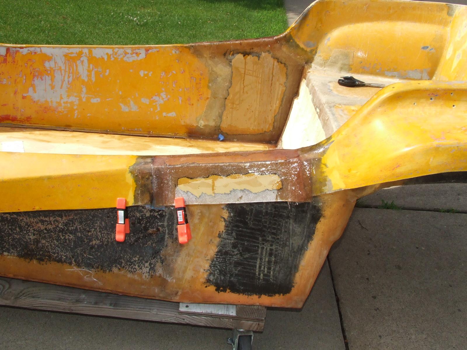

To fill gap... get a piece of plywood and wrap it in "plastic wrap" (Saran or Glad wrap) and use some screws to mount it to INSIDE of body then you do a glass and mat/cloth lay up from the outside of body spanning "stretch" area..... Once you have several layers of resin/cloth and "structure" of body is stable, remove screws and plywood panel and do finish work on inside of body..... Yes you probable need original body parts mounted to pan or at least some sort of solid framework to mount body to so everything stay straight and inline till all the resin/mat/cloth has a few days or weeks to mature and become "rigid"...
Only issue is to get body contour lines to look natural... Most cut and stretch jobs I have seem always have some awkward lines where person doing the work did not get the lines and curves to follow what should be natural "flow" of body....

PostPosted: Sat Dec 29, 2012 9:06 am    Post subject: Reply with quote
Was fetching the photo for the previous post, I am probably of best service to the community as an example of what not to do. Laughing Hope the photo helps a bit.
Dales explanation is more helpful than mine, he is one of the resources I have learned to respect here.

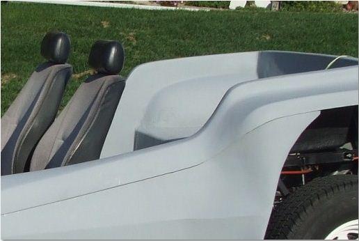

The old "Tuff Tub" utilizied a full sized floorpan.
Very good!....This seems to be one of the mods that got the lines and angles right.... Many do not....
I would be interested in seeing the process used for stretching the sidepods. Or are there full length sidepods available?

PostPosted: Sat Dec 29, 2012 2:33 pm    Post subject: Reply with quote
I actually fabricated those from scratch using the sides of a derelict boat. The boat had a nice body line that I incorporated into my sidepods and then carried that line into the bump out for the front and rear wheel wells. I think I saved a bundle in resin and mat and got a nice gelcoat finish to work with on large sections of the pods. The guy at the boat yard thought I was nuts cutting the sides out of a scrap boat. He was probably right... I get that a lot. Smile
They look ok, not perfect by a long shot but I learned a lot on that project too, not as many pictures.
