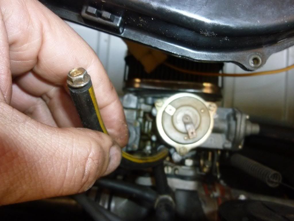

Hi,
Just recently this nice CE Westy came home from US into my hands Very Happy

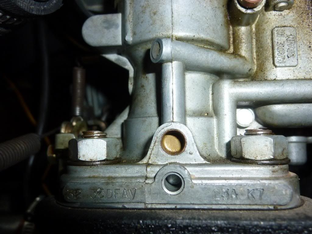

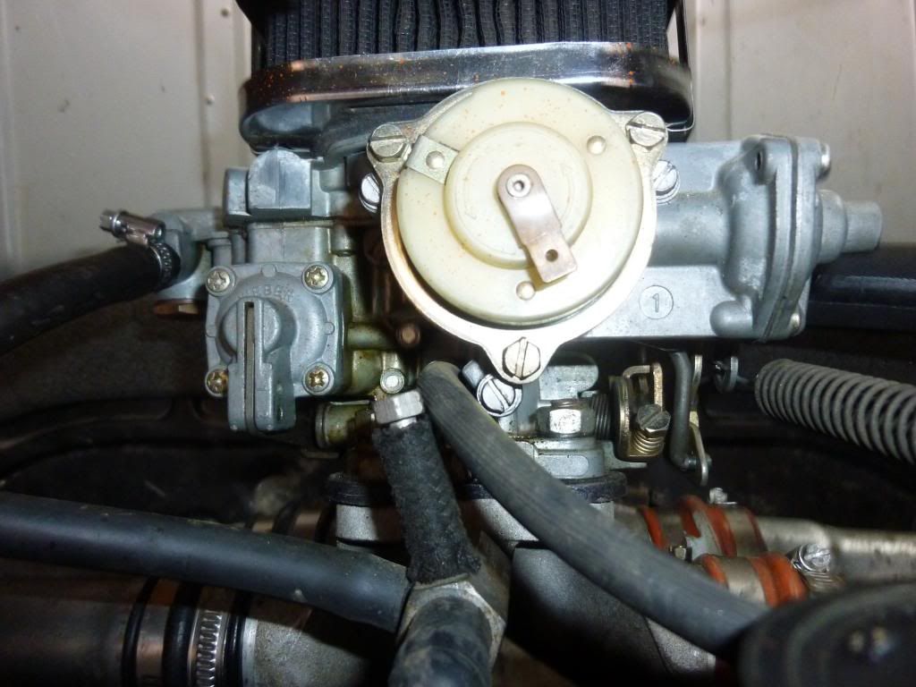

The former owner done some modifications. The origianl ignition was taken out and for that a Weber Carburator was put there.
32/36 DFAV 23A K7
The Problem is that this piece is poorly installed. Some tubes are just closed with a screw. Also the mixture is way too rich. I'll tried to connect the cold start with the ignition (pin 15) but this grilled some fuse Shocked
Is this okay to close the tubes like that?
Does anyone have this combination working in their Bus? Is it a good solution, regarding maintainability, fuel consumption and performance?
Was this sort of carb already used in the late 70s?
Would be great to find some fellows with the same configuration, because here in germany this combination is rather unknown.
best regards,
Marco
ps. if the former owner recognize his bus - it would be great to know him. not for punishment of the changes made Wink

Marco, There has been a lot of discussion here on Samba about these carbs. The Type 4 engine does not have any way to heat the intake manifold so the use of any center mount carb is going to be a problem as the carb will run icy cold even in warmer weather. They can be made to run decently but this takes a lot of fabricating to do well. Out of the box the carb tend to run lean coming off idle and have a bad bog, so many people jet their carb to run overly rich to prevent this, it sounds like that is how your carb is set up.
If you have any kind of pollution standards you need to meet, you will probably not be able to do it with this carb and should go back to the stock FI or maybe dual carbs since that is what I believe many European Type 4 powered buses used.

If you can find the pieced off of a European bus for the air preheat, building an adapter for the carb is easy enough, I am assuming they had this system. This will allow the bus to be driven down to temperatures of 5°C easily enough.
This is the setup I ran for years and it worked well enough, it used the heater box as a hot air source. I later got all the VW pieces together and used them instead of the heater box. Using the VW pieces made a noticeable improvement in how fast hot air got to the carb.
