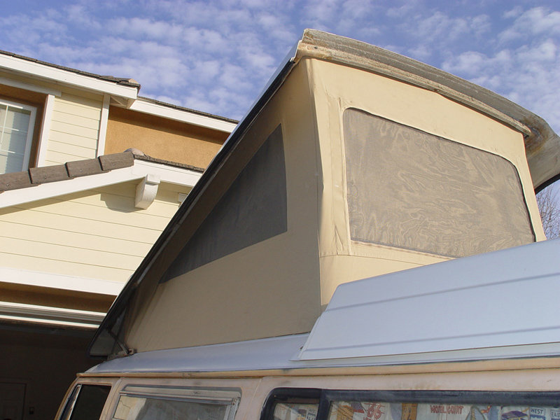

As you san see, it is a wood frame and the wood split off of the top with the wind, which explains why the hook did not hold the roof down.
I could use wood glue on this and in theory it will hold unless we hit another storm. But I am confused by something:
This shows the corner and it seems that there is some sort of edge on the poptop that is not wood that cracked. Is that some sort of fiberglass spray that was holding the wood to the roof?
I am in the Denver area passing through and heading West so if anyone has a bit of time this weekend with some space to work on this, I would be grateful. Alternatively, if anyone can tell me how they would do an emergency repair in this situation, I would also be grateful!
I'll never understand how the wind got enough force from below to lift the top up, given that it is pretty well sealed, but I guess nature is funny sometimes.

I think I would try to find some ratcheting straps at Walmart or something to get you home at least.
Sort of like this...
http://www.walmart.com/ip/Performance-4-Piece-Ratcheting-Tie-Down-Strap-Set-W1440/14299435
I would probably put them on 2 from front to back and 2 side to side to see if that helps.

You could probably glue that broken wood together with a few packs of two-pack epoxy and some small nails or screws to hold it together as the glue sets, to keep it going as a poptop that opens for camping -
And tie down with cargo straps on the road.
The 'fiberglass spray' is actually woven fiberglass tape covered in polyester resin - as used in boat and RV construction. Epoxy resin is better at sticking to old polyester resin than new polyester resin sticks to old.
When you get home replace the fiberglass tape that has broken at the corner with a new piece - using new tape glued with boat epoxy resin - the old tape will probably just pull away from the wood and the poptop, or break away using a chisel or screwdriver.

It took me nine hours to put up my pop top and tent but it took me several days to develop a strategy to do it. A can of fiberglass resin kit with fiber glass will cost you about less than $20 and clamps to reset your wood will run you at least $10 ea. from Harbor Freight. You will need to reset your wooden frame in the top by taking the Top off. If you want to do it cheaply just enough to get you back on the road, use Gorilla Glue which will set in a matter of hours and cost you less. You will also need a T-50 stapler to attach your strip on the frame. Good luck, I hope you make it out here.
