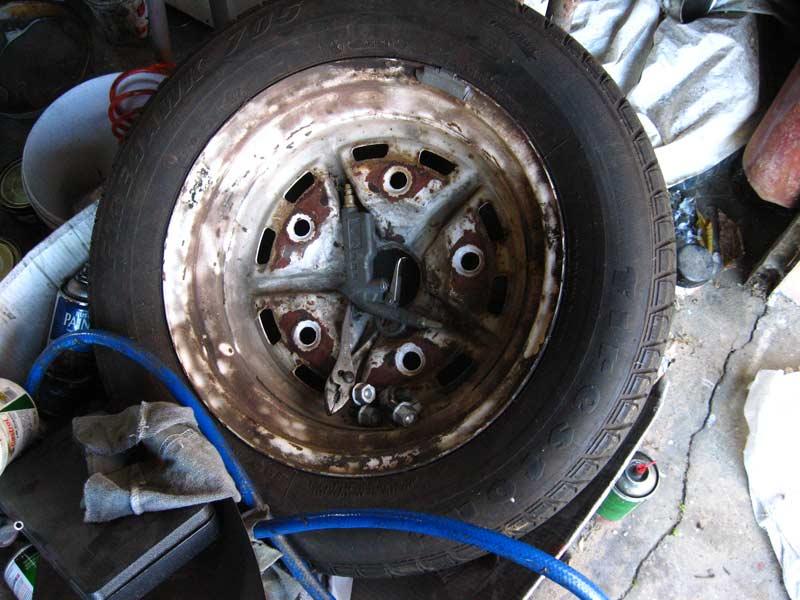

I was busy uploading pics so I thought I'd share some pics of the Rostyles I'm cleaning up for my bug. They have quite a few rust spots and were covered in a mountain of enamel infront. Rust is right around so it is a tire off deal...
First one was so rusted the PO put an innertube in (wrong sized to boot). I'm glad to
Glad to say its tubeless now.
I stripped the paint, derusted, then coated with zink, before adding primer and paint. Takes me a week per wheel, sigh.

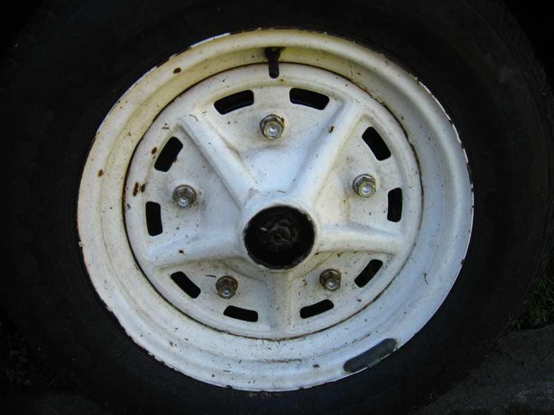

Ok, done with wheel number two, and took some pics again.
Started with this
The real thing.

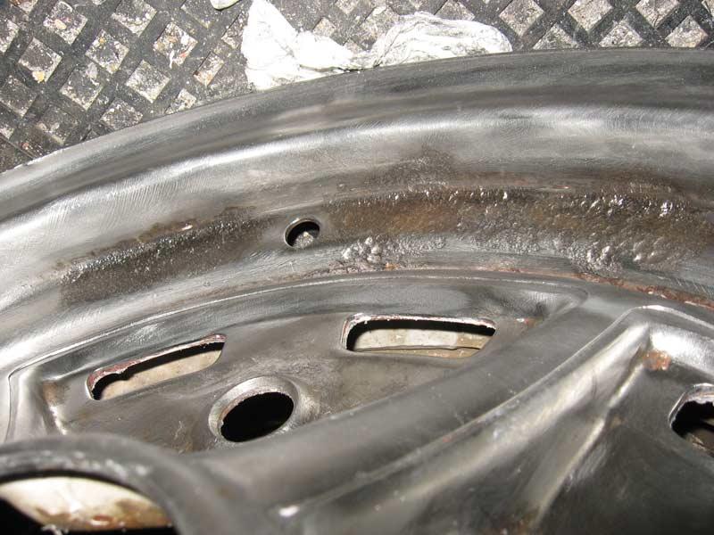

Lots of corrosion, hard to clean up, I also didn;t get the putty perfect when touching it up, but I'm happy with it overall.
Inside also needs to be cleaned.
One coat zink, one coat primer, then painted and cleared
